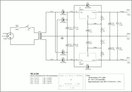

I'm looking at building a DC lab power supply, roughly 1.2-14 volts and up to about 1.5 A, based on the LM317 (and possibly also LM337) voltage regulators. However, I'm a bit torn between two choices when it comes to the basic design: a dual polarity design (+/- 1.2-14 V with LM317/LM337) or a dual rail (2x 1.2-14 V, completely individual rails, 2x LM317).
Example design for the dual polarity:
+/- supply schematic
(Credit: Jason Neal)
The reason I can't decide right now is that I don't understand the following:
  • If I go with dual polarity (e.g. +9/0/-9 V output), can I power two loads, perhaps with +9/0 for one and 0/-9 for the other? Both should act as if they each had a regular, +/ground supply. My understanding is that the current will go backwards in this case, so that the answer is no?
  • If I go with the dual separate, 2x positive design, can I wire it up to give the positive/negative output? For example, I've seen people bridge + from one rail and ground on the other, then use the remaining two outputs as +/- and the bridged one as ground.
    Will the example design be able to do this, without sacrificing output amperage or cause other problems?
As you can see, the goal is to get both features in a single supply, if possible (without quad rails or such madness).
In either case, I would have a single transformer; either a 12-0-12 V center tapped transformer, or a 2x12 V dual secondary transformer.

    See the schematic here (http://www.bb-elec.com/bb-elec/literature/12vdpsin.pdf) for an example of how to generate two isolated unregulated supplies from two secondary windings on the same transformer. If you add a separate LM317 circuit to each of these unregulated supplies you'll have dual regulated supplies at some voltage less than 12 V. If you tie the high side of one to the low of the other, you'll have a +/- supply. More detail later (probably a fix-up to my previous answer, which was overly-restrictive about what you can do) if I have time. – The Photon Feb 14 '12 at 21:47
A typical use of the power supply schematic in the O.P. is for powering one (1) analog circuit, which needs both positive and negative power supply rails. In principle, you can power two (2) completely independent circuits from it (+9 to 0 and 0 to -9). This would be a peculiar scheme, though, because the ground of one circuit is at 9V (plus or minus) w.r.t. ground of the other one. Still, if the circuits are in fact independent, such scheme would work. In practice, this scheme is not used in general purpose desktop power supplies.
A classic desktop power supply (like the one in the YouTube video linked in the O.P.) is of a "dual positive type". Each channel has its own independent secondary winding (or even a separate transformer) and its own rectifier. The channels can float with respect to each-other, and that allows to connect them in series.

  • Sounds good! So if I go with the dual positive design, with a dual-secondary transformer followed by two separate circuits (two bridge rectifiers, two sets of smoothing caps, two LM317s) I should essentially be able to get both of these features in one supply? Would it still be possible to utilize a single ADC to measure voltage in both rails, though? Sounds like the separation could cause trouble there. – exscape Feb 14 '12 at 21:25
  • @exscape "How to make measurements on separate floating power supply channels?" Is a good subject for a separate question. With galvanic isolation of analog signal or ADC's digital lines, you can measure while the channel remains floating. – Nick Alexeev Feb 14 '12 at 21:39
    @exscape: don't forget that for a dual positive you need two separate secondary windings (or two separate transformers). Your centre-tapped secondary won't do. – Wouter van Ooijen Feb 14 '12 at 22:35
  • @WoutervanOoijen thanks, I know. I've been looking at a 2x 12 V / 2x 1.7 A dual secondary as well as the center-tapped one. :) – exscape Feb 15 '12 at 07:15
