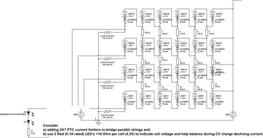

simulate this circuit – Schematic created using CircuitLab New batteries are balanced <0.1% but aging and C/40 usage can quickly age this imbalance to 1% and at 10% the battery is no good in the array. This can be measured by internal ESR and meter or with LED indicators in the array to help balance.
  • Smart balancers use a half bridge PWM with series L between each string cell and can get complex unless designed on a PCB or purchased.
  • dumb balancers use passive loading like TVS Zener with PTC protection rated power of 10% during CV mode charge current.
  • I suggested cheap Red Power LED's as both passive balancer and indicator if carefully chosen.
  • at first this may seem like overkill until batteries age and you want to extend life by balancing then removing mismatched failing cells.
  • IF you install thin short wires between cells, they can act as Fuses just like the ones in Tesla 2 batteries. Then you can reduce but not eliminate the risk of mismatched cells shorting out. Tesla batteries all have microfuses on each anode and cathode of 4000++ cells
  • then with <0.5% matching you can string many hundredsin parallel
** - compute max ESR of string and increase 25% with matched short ESR fuse wire divided by total N cells using AWG tables for ESR/mm **
  • I'm already going to make ~500 solder joints, I honestly don't see myself making any more than that due to time constraints. I just need to know: Will balance charging a 6SPx block (not individual cells) in my supplied picture, while everything is connected together, charge cells in the other 6SPx blocks? – heilstalin Oct 26 '16 at 19:12
  • I can't say for sure, but what I recommend is use the wire resistance to match the ESR of the battery. Same with LED's in parallel I know ESR=1/Pd and in same batch I can get Vf @If within <1mV yet specs are +/-200mV so I discovered best way to put 3W LEDs in parallel is Normalize the ESR with a fixed wire resistance approximately equal to the LED ESR (1/3 Ohm in my case xx mOhm in your case as a safety against Thermal Runaway using a low Z Voltage Source. But if your charger is Current limited you need to ensure 1 string does not hog all current and lowest ESR will do this. – Tony Stewart EE75 Oct 26 '16 at 19:28
  • There is a risk of Thermal Runaway when Battery Voltage drops from lower Voltage chemical sensitivity (I believe) due to self heating thus drawing more current from other parallel cells.... this positive feedback effect can lead to self-destruction.. Using much less than max rated Charge speed reduces self-heating and this risk. In diodes. Vf drops with rising temps, I am not sure about LiPo's if it is PTC or NTC – Tony Stewart EE75 Oct 26 '16 at 19:32
  • Wouldn't it be easier to just put a bunch of thermistors throughout the whole pack wired to an arduino or 2 and just flick off a relay if the temp gets to a threshold? I'm gonna be drawing about 1200w max sustained from the pack and thats half of the theoretical maximum @ 25°c. Its simple, cheap protection. – heilstalin Oct 26 '16 at 22:35
  • It is better to design current limiting than rely on OTP. My schematic is best for this, as a starting point. OK? Take a better look at balancer designs. rather than 24 thermistors and string relays – Tony Stewart EE75 Oct 26 '16 at 23:47

  • [This is my pack.](http://i.imgur.com/hMfbE2V.png) Can I charge the area in the red without affecting/charging the rest of the pack (in blue)? what application - Powering a 1kw motor what cells - Samsung 26F what currents - ~20A what charger - 6S, 6A Balancer+Charger – heilstalin Oct 27 '16 at 00:49
  • @heilstalin Nice diagram. Which circuit lab was that drawn with ? - via embedded version here or elsewhere? | ALMOST there. Knowing HOW the balancer works and could be made to work is crucial to the answer. I'll assume the balancer can work magic as required. Then -> Answer: Only with EXTREME care and cunning. -> IF you measure the voltage across the pack before balancing AND if the main pack voltage does not change AND if you do not change the net voltage across the subset that you are "balancing", THEN you may be able to do this ... – Russell McMahon Oct 27 '16 at 04:23
  • ... without affecting the others. But only if there is NO net current between the subset and the remainder of the pack at any time . IF you could monitor this it would make it easier (small sense resistor per 6S. eg 1 milliOhm at 20A = 20 mV at full current = much less at balance currents. And/but, as the balancer is not affecting the rest of the pack then opening the string (1 FET) during balancing and THEN voltage matching the string to the rest of the pack and then closing the switch may work as well and be easier. But the string is now not strictly the same as the rest of the pack. – Russell McMahon Oct 27 '16 at 04:24
