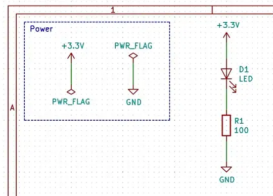

As a newbie I found this difficult to understand and it remains very non-intuitive (at least from a programmer's perspective) to have the ground (logical circuit output) "logically" defined as an input.
The answer from @mbrig put me on the right track, but I still had errors elsewhere until I understood the requirements to separately flag each power network with the PWR_FLAG symbol, explained here: KiCad pin connected to some others pins but no pin to drive it.
Create this kind of group somewhere else on your EE schema diagram, continue to use the more intuitive +#V/VCC and GND symbols in your actual main circuit, and the errors go away.

    That just silences the warning though -- you want the PWR_FLAG at the place where the power comes in (e.g. near the connector for the power supply). – Simon Richter Jan 24 '21 at 14:07
