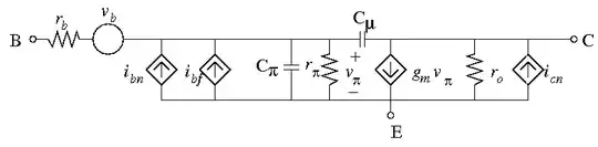

Using transistor in High frequency will cause some problems , that engineer will have to work them out while designing . First I will show the difference between BJT(as example, it also applies to other types ) transistor in low frequency & high frequency :
This is the model of BJT in low frequency with noise : enter image description here

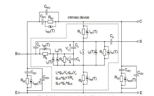

This the model in High frequency

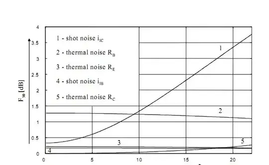

The below figure will show you how many noise effects are added while the frequency increases enter image description here
All of this will make it harder to design in high frequency ,
