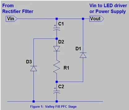

This covers a subset case only, but deserves a minor answer in its own right (rather than a comment which can be deleted or missed.)
Some power supplies take advantage of the AC input variation to provide a smoother DC output than would occur with rectification and a given degree of smoothing.
Operation of these circuits on DC input will violate assumptions made by the circuit designer and may have implications for power dissipation or other functionality.
One example are "valley fill circuits" (wikipedia) which charge capacitors in series at high input voltage and then discharge them in parallel at lower voltages as Vin falls towards the AC zero crossing point. These circuits are more common n modest power applications such as LED lighting where avoidance of mains frequency induced flicker is important. These are similar to some power factor correction circuits mentioned below but the primary purpose may not be the same. (Wit LED drivers the arrangement may bot improve flicker performance and improve regulatory compliance.)
C1 & C2 charge in series and discharge in parallel - acting as a Vin_high halver to supply current during low Vin periods.
From here . They see this as a PFC correction circuit.
