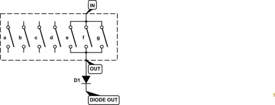

Figure 1. Since accidental contact closure is not an issue the switch contacts can simply be wired in parallel for redundancy.
Using this arrangement any multiplexed configuration including charlieplexing can be used. I don't think you can use less than one diode per switch except for switch 17 (4 x 4 + 1) as it may be on it's own dedicated pin. That makes 16 diodes the minimum.

  • I already mentioned this exact configuration in my question. – AJMansfield Sep 29 '16 at 18:17
    I read it twice before I answered. Schematics are better than words. This uses one diode per switch. Are you asking to improve on that? – Transistor Sep 29 '16 at 18:21
    I already have a way to do this with \$\lceil\frac{1}{2}\sqrt{4 k+1}+\frac{1}{2}\rceil\$ diodes and \$\lceil\frac{1}{2}\sqrt{4 k+1}+\frac{1}{2}\rceil\$ pins just with putting the switches in parallel. I am trying to do better than that. – AJMansfield Sep 29 '16 at 18:51
    What's "k"? Add a schematic to your question. Even if you don't get a decent answer it may help someone else. – Transistor Sep 29 '16 at 21:27
