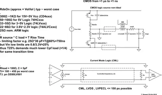

Let's me add a different perspective to the excellent answers using first order RC effects. I assume the reader is aware of lumped element and transmission line effects.
Historically, since CMOS was produced, they wanted to supply a wide range Vss limits but avoid Shoot-Thru during transition, so RdsOn had to be limited. This also limited rise time and transition frequency.
  • As technology improved with small lithography and smaller RdsOn, while the Cout actually increases but they are able to reduce Cin since it acts as a buffer. They had to limit Vss due to thermal effects and risk of Shoot-Thru with very low RdsOn.
  • This is still the challenge seen in half-Bridge PWM motor drivers and SMPS
RdsOn (approx = Vol/Iol ) typ ~ worst case
  • 300Ω ~1KΩ for 15V~5V Vcc (CD4xxx)
  • 50~100Ω for 5V Logic 74HCxxx
  • 33~55Ω for 3~5V Logic (74LVxxx)
  • 22~66Ω for 3.6V~2.3V logic (74ALVCxxx)
  • 25Ω nom. ARM logic
    • R source * C load ≈ T Rise Time to 60%V
  • limiting factor e.g. 25Ω*30 pF = T@60% = 750ns
  • but actual thresholds may be 50% or +/-25%
Conclusion:
Without perfect transmission line controlled impedances, CMOS switched voltages can never approach the speeds possible with Current mode Differential Logic.
Although this adds a lot of complexity and cost, so industry instead goes with smaller Litho inside one package to limit the stray capacitance and interconnect speed can be slower.
Then parallel CPU's is more power efficient than fast CPU speeds. This is due to the power dissipated during IR transition times determined by RdsOnC to achieve higher speeds.
If you examine all MOSFET datasheets you will find RdsOn is inverse with Ciss within any family or technology.
