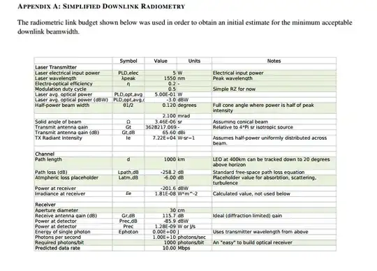

In "Free-Space Laser Communications: Principles and Advances", the following example link budget is proposed:
Unfortunately, no justification is provided for the "Clear air transmission loss" term, which is about 11km at 0.2dB/km, rather than 483km.
In another system, a comparable attenuation term is used enter image description here
Is the atmospheric attenuation this low because it decreases with altitude (and 0.2 dB/km is the attenuation coefficient near sea level)? How do you go about making that computation. If the altitude dependence is significant, it is not discussed in the book. If the effect of atmospheric attenuation becomes negligible beyond a certain altitude, where would that be?

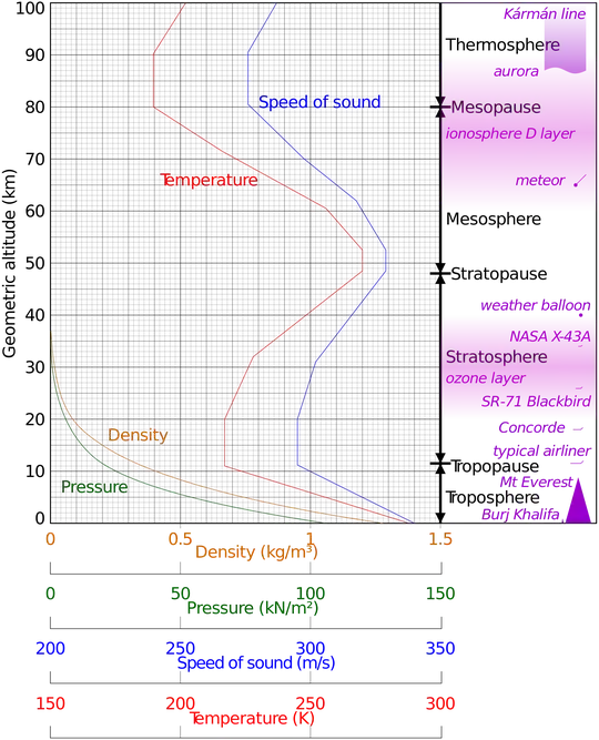

Earth atmosphere profile
Image source: wikipedia article on Atmosphere of Earth.
