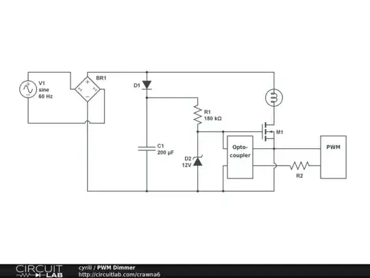

I have built this circuit to dim a lamp with a PWM signal. It had an issue where the MOSFET was getting really hot. So I wanted to know what was happening on the gate of the MOSFET.
I turned the PWM signal off and with my multimeter I measured \$V_{GS}\$ as 12V. Now confident that I can look at the waveform with my little USB-oscilloscope (rated to 20V) I connected it. Bammm, the lights go out and I'm left with a bricked oscilloscope and PC that was connected to it.
I'm quite sad about breaking my PC. However I have to know what went wrong so I'm here.
About the problem with the hot MOSFET: It turns out there was a bug in the code making the PWM frequency very high. Making sure it was 200Hz fixed the overheating and the dimmer appears to be working as intended now.

    What is your V1, is it the mains? In that case you more or less connected your PCs groud to it. Poor PC... – Wouter van Ooijen Sep 25 '16 at 19:12
    @WoutervanOoijen points out, this is all about the ground reference. Your oscilloscope not only requires that the differential voltage is within an acceptable range, but that each individual input (you can also think about the common mode) absolutely referenced to ground is not too large. Yours was too large... Doesn't affect the multimeter, because it is battery operated and isolated, so has no absolute voltage reference. – Ben Voigt Sep 25 '16 at 19:14
    And may I suggest (unless you're in for a Darwin award) that you refrain from building things that are directly mains connected untill you're absolutely sure you know what you are doing? In your circuit, C1 cries out *danger* and *don't touch me*! At the very least put a bleeder resistor across its terminals, and include a resistor that limits the inrush current. – Wouter van Ooijen Sep 25 '16 at 19:19
  • thanks. that cleared it up.. there is a thermistor after the brige rectifier (forgot to put it on the diagram). wouldnt C1 discharge trough R1 to 12V (rather slowly)? i'm aware not to touch anything at all, but my pc says that maybe you're right, so there's that. – cyrili101 Sep 25 '16 at 19:25
    In addition to all that, why is part of your low-voltage optocoupler-PWM circuit connected to the source of the mosfet (and thus negative mains potential)? – marcelm Sep 25 '16 at 20:29
  • Why do you have such a large value for C1? There's a lot of unnecessary hazardous stored energy there, I would think it could be a lot smaller, so long as C1 * R1 is a few times greater than 1/(120 Hz). – pericynthion Sep 25 '16 at 20:32
    Use an [isolation transformer](https://en.wikipedia.org/wiki/Isolation_transformer) when prototyping mains voltage circuitry instead of just directly plugging stuff to the grid. This way you and your equipment will have to touch *two* (as opposed to one) live conductors simultaneously to die or break, respectively. See this post for details: http://electronics.stackexchange.com/questions/17496/how-is-using-a-transformer-for-isolation-safer-than-directly-connecting-to-the-p/17500 – jms Sep 25 '16 at 21:29
    I would imagine there's a decent chance your PC and scope are fixable. (if you're lucky you might just need to replace a fuse) – user253751 Sep 25 '16 at 21:56
  • It is _still_ not clear to me if V1 is directly at mains voltage or not. It would be very simple to just show the voltage on the actual schematic. – pipe Sep 26 '16 at 04:17
  • Never connect your oscilloscope to live mains!!!!!!! The grounding of the oscilloscope will get you!!!!!!! – Bradman175 Sep 26 '16 at 09:33

Since the circuit is not isolated the bottom line of your circuit moves around with the mains voltage.
  • On positive half-cycles (b) the bottom of M2 would normally be held at about 0.7 V above neutral voltage. Since this is connected to mains earth - that's 0.7 V above earth. Since the oscilloscope and PC provide a lower resistance path to earth than the diode the current will flow through them rather than the diode. Your equipment might survive 0.7 V if the cable resistance is high enough to limit the current.
  • On negative half-cycles (c) the bottom of M3 is pulled to -170 V peak (if you're on 120 V supply). A high current will flow from the PC / oscilloscope ground as it is providing a short circuit from earth. This current likely burnt up several ground traces on the PCBs it ran through. Once they were gone the voltage would have been applied to the chips, etc., and they were destroyed as well.
It's a tough lesson so learn it well. Make sure you understand the logic of the explanation above. If you can do that you will have learned more for the cost of replacing your equipment than many do at fee-paying courses.

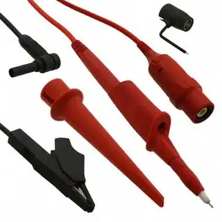

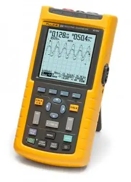

Figure 1 and 2. Fluke Scopemeter and probe set. Note insulated "BNC" connector and leads including black plug on earth clip lead (which plugs into side of probe). The meter comes with a PSU jack that doesn't make contact with the internals until after the exposed metal has been inserted. An optical serial port is visible on the side of the scope.
Instruments such as the scopemeter in Figure 2 are fully insulated. As a result the scope ground can be connected to any point on the circuit under investigation including the rectified negative line of Figure 1. Even when on charge the device is fully isolated from mains earth. The only point to watch is that the earth clips of the supplied A and B channel probes are not connected to two different potentials.

The circuit shown is AC mains connected without any kind of isolation. Measuring Vgs using a multimeter is safe because the multimeter is 'floating' with respect to the mains supply.
But a PC is not floating. The PC is normally has the grounded case, meaning the metallic shield on the USB connector is also grounded to the mains power point through the PC case.
As such, connecting the USB oscilloscope to the mains connected circuit is inevitably disastrous. When this is done, mains voltage will push current into the PC case (or into the USB data lines, depends which probe is linked) to be returned to the ground.
All mains linked circuit must be instrumented by floating equipment. You might be at safe side if you used a laptop instead of PC, but its not so safe either unless you really insulated everything around the laptop and ensured your laptop is really floating with respect to the ground.

So close, yet disaster. Web resources should be double-checked, especially where line-voltage circuits are concerned. Circuit-Lab should be notified that they've published a guaranteed PC-killer, and a possible people-killer. These expensive lessons are never forgotten by those who survive.
Kudos to you for discovering that fast PWM causes a hot MOSfet, and slow PWM is a solution. A circuit revision that reduces the 180K resistor to 10K will also help somewhat. Your solution of very slow PWM of 200Hz. is also a decent work-around. Be careful of choosing frequencies that are multiples of line frequency - for example, choosing 240 Hz. where line frequency is 60 Hz. will give an interesting optical effect.
The main revision to this circuit to avoid disaster involves completely isolating the PWM source from the MOSFET driver, like so: enter image description here One should also take care to make component choice carefully. BR1 must be rated in voltage to easily take peak-to-peak line voltage. It must also be rated to pass lamp current with some considerable head-room, since lamps require a surge current when cold, until they reach operating temperature. Diode D1 can be a small diode, because little current is required of it, but it must be rated for at least peak line voltage. It would be safer to choose a voltage rating of peak-to-peak line voltage.
Probing this circuit with any oscilloscope is a 'scope-killer. No 'scope I've used could withstand its ground connection (0v reference) going to any part of this circuit other than PWM source. If your USB oscilloscope has a spec-sheet, carefully find its common-mode voltage limit. This tells you how far from ground its input circuit can deviate before some part of it fails. Some are only a few volts. This circuit would require hundreds of volts of common-mode range. Always assume that a 'scope's 0v reference is connected directly to ground, and always keep in mind that most parts of this circuit will result in spectacular failure when grounded.

Understand that tungsten lamps have a large temp rise >3200'C and NTC of 10:1 cold to hot resistance, thus if PWM pulses at a slow rate or too fast, Ipk can reach 10x bulb rated current or have large dynamic losses and FET RdsOn with resistance may gets warmer with I^2R=Pd
Note that line and neutral are not labelled , and neither V+ or V- is at ground but we know Neutral is at least grounded at outside transformer. Thus without care, you can be connecting probe ground to rectified line instead of 2 diode drops from neutral.
This requires two 10M probes rated for 400v in differential A-B mode.

    I'd use something like a Fluke Scopemeter which is fully isolated and finger-proof (and the PSU jack is touchproof and case is appropriately rated). The "GND" input can be connected anywhere on the circuit. Option 2 is to take a differential measurement. I agree that this can be difficult if the small signal is swamped by the mains voltage. The topic of live chassis oscilloscopes has been covered here before and I've seen it done and felt most uncomfortable being near it. I wonder to any of the PicoScope range offer isolated input facilities with fully insulated probes? – Transistor Sep 26 '16 at 13:52
