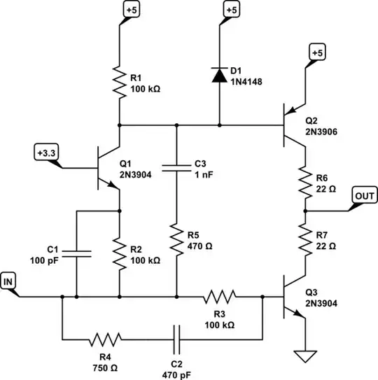

McMahon's circuit will work fine if you can find a BJT with very fast reverse transit times. (Low diffusion charge storage.) I like the idea of driving, by pulling through the emitter. But I worry a little that it will not work with the usual BJTs you might normally find. So if you want to try his circuit, make sure you pick a fast BJT. Perhaps try something like a 2N3391A, instead of a 2N2222A or 2N3904. Just be prepared to try different ones until you get a decent output at the frequency you want.
If the BJT has a poor reverse transit time, then you can find this out by observing the base voltage of McMahon's circuit with a 100X probe on the scope. Look for a voltage above \$3.3\:\textrm{V}\$. If you see the base higher, while driving the circuit fast, then you probably have to find a different BJT.
If you want to use pretty much any BJT, you'll need a different topology that is a lot more complex. I'm not recommending the following. (I think you'd be better off with McMahon's circuit and the right BJT.) But here's an illustration of what you might face if you want to use most any BJT:
Assuming \$200\:\Omega\$ driver impedances (and still more) it should keep up easily with \$1\:\textrm{MHz}\$. Drive currents will peak only for a very short moment, but generally will be at or below \$3\:\textrm{mA}\$. The circuit uses speed-ups (\$R_4\$, \$R_5\$, \$C_2\$, \$C_3\$, and \$C_1\$.)
Now if that doesn't convince you to use McMahon's approach, nothing will. But plan on selecting an appropriate BJT.
