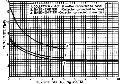

The graph shows the variation of capacitance with reverse voltage.
So connection 2 would give the behaviour most similar to the 1N4148.

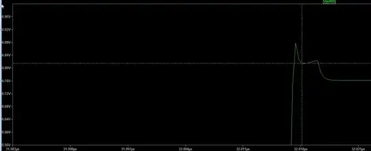

Here is the slight overshoot in the response with the LED open and a 2N3904 connected as I suggested (+/-10V input through a 220R resistor), 10ns rise and fall times simulated in LTSpice with 1ns maximum step size:
