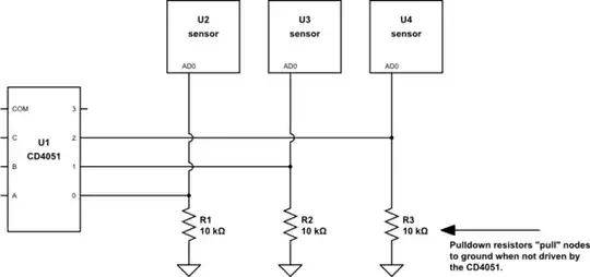

    Your software implies that Arduino pins 3, 4 and 5 are connected to the CD4051, but your schematic does not show this. Are you sure that those connections are correct? Can you verify that the three AD0 lines are switching in the way that you intend? The CD4051 is an *analog* switch, which means that the deselected pins are *open-circuit*. Are you using pull-down resistors to make sure that the AD0 lines are seen as logic "0" when not selected? – Dave Tweed Sep 24 '16 at 11:39
  • @DaveTweed Hi Dave! Thanks a lot for your reply. Yes you're exactly right, I forgot to add in those selecting channel pins in the schematic, but I did have them in the actual circuit. Thank you for pointing that out, I'll edit that again. For the open-circuit part, I hadn't done that. I'm not sure about what it is and I would really appreciate if you could clarify that, also how can I determine the value for the pull-down resistor? Thanks so much! – A.Gomes Sep 24 '16 at 12:05
    It isn't clear from your comment, but you may have misunderstood what "pulldown" means. I'll create an answer below, since I can't include a diagram here. – Dave Tweed Sep 24 '16 at 13:20
Your software implies that Arduino pins 3, 4 and 5 are connected to the CD4051, but your schematic does not show this. Are you sure that those connections are correct? Can you verify that the three AD0 lines are switching in the way that you intend? The CD4051 is an analog switch, which means that the deselected pins are open-circuit. Are you using pull-down resistors to make sure that the AD0 lines are seen as logic "0" when not selected?
The pulldown resistor needs to be small enough so that it can overcome any leakage currents that are trying to pull the pin high -- and also discharge the node capacitance reasonably quickly -- but not so small that the drive coming through the CD4051 can't overcome the resistor. For CMOS logic, values in the range of 10K to 100K are usually good.
As an alternative, you might consider switching to a decoder that doesn't tristate its outputs, such as a 74HC138. This particular chip has active-low outputs, which means that you would have to switch which address you consider to be the "active" address in your firmware.
There's one more side issue that I can't resist commenting on. You have written your software using global variables exclusively. I'm guessing that your programming background is mainly in the BASIC language. This is OK for small projects, but will get you into trouble with anything more complex. In the C language and its derivatives, you'll want to learn how to use local variables within functions, and how to use parameters and return values to pass data into and out of functions without using global variables.
