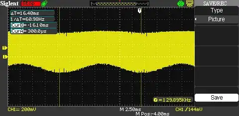

UPDATE: For those that would like an update: I built this circuit with a vanilla op-amp and instrumentation amplifier, with the instrumentation amplifier having a G=100, Vin= 1Vpp sinewave at 60Hz, Rsns=1R, and ZL=22R, and I see my 60Hz signal "amplitude modulated", if you will, at an oscillation frequency of 133kHz. Here is the oscilloscope trace across ZL. oscilloscope trace

  • So if there is a sinewave at the input, am I correct in assuming the "importance" of the delay in the gain loop in relation to oscillation is dependent on that frequency? Or will the circuit oscillate independent of a signal at the input? – Jordan Sep 14 '16 at 19:08
  • In real life there is usually enough noise to get things going. If you're interested in simulation (and you ought to be) then feed the input a square wave and look at the decay of the overshoot (if any) to see what kind of damping you are getting. The closer you are to oscillation the longer it will take for the ringing to die out, until the ringing gets bigger each cycle and you have an oscillator. Check under varying load conditions including some parasitics too. – Spehro Pefhany Sep 14 '16 at 19:14
