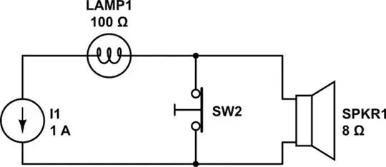

Yes, this circuit diagram is correct. No, I did not design it.
How do I describe this circuit in words? I thought about "a switch and light bulb in parallel, instead of series" but the circuit is so bizarre that I want to make sure what I am saying is unambiguous.
I cannot insert a schematic/picture/diagram/drawing, and I have a fairly tight word limit.
If anyone knows the tags for this question, add them.
EDIT (due to interest from the comments): The circuit was made by my 3rd grade teacher for an electricity test (when she thought the questions from the curriculum were too hard for us...)
EDIT 2: No, this is not a fancy NOT gate. The question was "What will happen when the switch closes" and the teacher-accepted answer being "Lightbulb turns on"
dpdt

Do you want subjective opinion? Or technical description?
Subjective opinion would be: this circuit is badly designed, no matter what problem the designer tried to solve.
Technical description would be: it is a battery killer with stand-by indicator.

The best description for this circuit is "How to NOT control a light with a switch." This was clearly not designed by anyone with even basic knowledge of electricity. Or else it was incorrectly "interpreted" or reproduced by someone with absolutely no understanding at all.
Obviously, closing the switch will put a DEAD SHORT across the power supply. That is NEVER a good idea, and can be quite dangerous in many cases.
Clearly, the light bulb (or LED, it makes no difference!) turns OFF when the switch is closed. Anyone who thinks otherwise has zero understanding of electricity and should not be attempting to teach others. In any grade.

"Battery short circuit stress tester".
This circuit will allow you to observe how the supply source reacts when short circuited. Also tests the switch under extreme fault conditions as well. An expendable person should be deployed to operate the switch.

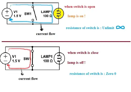

Current tends to select line with lower resistance. Short circuit resistance is 0 and open circuit resistance is unlimited. The current of lamp when switch is closed = zero then you have no light but when switch is open the current of lamp is (1.5v/100ohm = 0.015A) then you have light like this picture : enter image description here
and something about the battery :

I'd describe it as: Switch and bulb in parallel connected to a voltage source.
I think the voltage source should be mentioned (without it you cannot reproduce the circuit, although most would think implicitly that a voltage source is there).
And I don't think a description should contain any hint that this is a quite useless contraption, stuff in school is often not useful or practical but only a test to see if the concepts are understood. An explanation of how it works can contain all the comments on how dangerous and useless this might be. However the solution is wrong - like pointed out by everyone else, if the switch is closed the light will go out.

I would describe it as a:
"Inverted bulb short ckt w' switch."
Or if you want to describe the circuit construction through words:
"Bulb+switch in parallel"
Though, you could also describe it as:
"Simplest bulb NOT gate."
