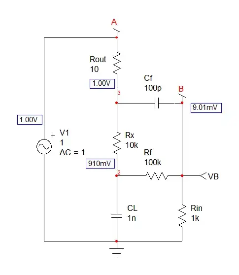

I believe the authors used fast analytical circuits techniques or FACTs but I am not sure about their results. The principle is based on the generalized Extra-Element Theorem or EET from Dr. Middlebrook. If I try to determine the transfer function of the below passive circuit in which I put arbitrary components values:
I can write the transfer function linking B to A under the form \$H(s)=H_0\frac{N(s)}{D(s)}\$ in which \$H_0\$ is the gain determined for \$s=0\$ when all caps are open. The first thing is to open the caps and determine the transfer function in this mode. Then, reduce the excitation to 0 V (replace it by a short circuit) and "look" at the resistance from the capacitor terminals in this mode. This resistance multiplied by the capacitor forms the time constant, \$\tau=RC\$. Summing these time constants gives \$b_1\$ in \$D(s)\$. \$b_2\$ is obtained by summing a product of time constants re-using one of the time constants in \$b_1\$. If I chose to re-use \$\tau_L\$ meaning the time constant associated with \$C_L\$, then I will put this capacitor in its hi-frequency state (a short circuit) and "look" at the resistance offered by \$C_f\$ terminals in this configuration. All these operations are shown in the below sketch:
From there, you can assemble a second-order polynomial form:
\$D(s)=1+s(\tau_1+\tau_2)+s^2\tau_1\tau_{12}=1+\frac{s}{\omega_0Q}+(\frac{s}{\omega_0})^2\$ calculate the quality factor \$Q\$ and factor \$D\$ as two cascaded poles if \$Q<<1\$: \$D(s)=(1+\frac{s}{\omega_{p1}})(1+\frac{s}{\omega_{p2}})\$ in which \$\omega_{p1}=Q\omega_0\$ and \$\omega_{p2}=\frac{\omega_0}{Q}\$.
For the zeros, you can either use a null double injection (NDI) or a generalized 2nd-order form as described in my book on FACTs. It is a bit longer than the NDI but sometimes simpler to implement. The corresponding schematic for this exercise is here:
If you develop the numerator, you obtain a double zero:
\$N(s)=1+\frac{s}{\omega_{0N}Q_N}+(\frac{s}{\omega_{0N}})^2\$ and cannot really split it as two cascaded zeros as the two are coincident (\$Q\$ is almost 1)

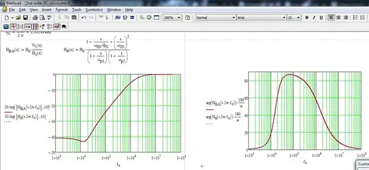

The final transfer function is given in the below Mathcad shots with the frequency response. You can see that this circuit builds phase boost between the poles and zeros and will certainly improve phase margin at crossover when used in a compensator.
enter image description here enter image description here enter image description here
