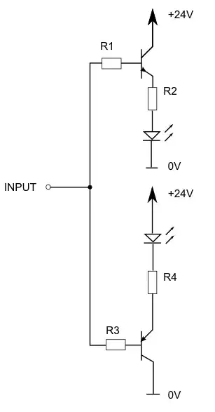

I ran into a problem which I tought was extremely simple, and after giving it some thought for more than 2 hours I had to recognise it actually is quite complicated. The problem is the following:
  • I have a circuit which runs on a +24V power supply, so only discrete components are available (no integreated circuit)
  • The input of the system is a single digital input that can be either at low level, at high level, or disconnected
  • When input is at 0V level, I want the first LED to emit light. When the input is at +24V level, I want the second LED to emit light. When the input is unconnected (left open), I do not the LEDS to emit light.
  • The leds use a high current (25 to 50 mA) so they must not rely on the input to provide this current, it should be buffered with transistors
The solution that does this with the smallest amount of discrete components will be approved.
For some reason, all my solutions could not shut both transistors at the same time, and I always had the rist of having some unwanted current putting them in linear mode, leading to LEDs being partially lit up. I do not want that, I want a current as close as possible to zero through the LEDs when they are shutted off.
Also, last but not least I do not with to be tied to a particular transistor model or whathever, so please use generic component whenever possible.
EDIT : So here is my schematic. It works fine for cases where the input is close to 0V or power supply. It however does not work when the input is unconnected, because current can flow through R1 and R3, and it will put transistors in linear mode and send some unwanted current through the LEDs.
I tried a similar circuit using common emmiter instead of common collector, but the fundamental problem is the same, when the input is left floating, the current can make it's way through the base of both transistors at the same time, putting them in linear mode, and having some current in the LEDs :
(Just trying the builtin schematic for the 1st time, so don't blame me. Please ignore resistor values, they have absolutely no meaning whatsoever).

  • I really don't see how the first part of the first bullet implies the second part... – Eugene Sh. Sep 09 '16 at 18:18
  • When the input is disconnected, what is its voltage - or how can you distinguish the disconnected state? – Peter Bennett Sep 09 '16 at 18:18
  • @Peter Bennett The input is left floating, it doesn't matter it's voltage but it's not being actively tied to any of the power rail. – Bregalad Sep 09 '16 at 18:19
  • Of course it matters... It's a state you want to detect, so you should know what to detect. – Eugene Sh. Sep 09 '16 at 18:20
  • We can have the circuit defaulting to any voltage, I do not care. As long as no leds is turned on when nothing is physically connected to the input, that's all that matters to me. – Bregalad Sep 09 '16 at 18:21
    @Bregalad I think you are confusing what we are doing here. We are not designing for you, we are helping you to fix *your* design. – Eugene Sh. Sep 09 '16 at 18:23
  • @EugeneSh. So that's probably while I'm failing at solving this problem, I'm mixing current and voltage point of view at the same time... right ? – Bregalad Sep 09 '16 at 18:23
  • @EugeneSh. I'm wishing to add the schematic of any of my failed solutions if that's necessary. – Bregalad Sep 09 '16 at 18:24
  • Sure. Add them. – Eugene Sh. Sep 09 '16 at 18:25
  • Perhaps rather than detecting an unconnected state, you specify limits or ranges on the High and Low states - for example, you might accept anything under 1 volt as low, and anything over 23 volts as high, then an input between 1 and 23 volts would be considered Not Connected. – Peter Bennett Sep 09 '16 at 18:33
  • @EugeneSh. Done. – Bregalad Sep 09 '16 at 19:02
  • connected voltage between 0 and 24V is not the same as open circuit. so it is poorly defined without margins and this condition. – Tony Stewart EE75 Sep 10 '16 at 04:41
  • This type of question is fun to find "simple" solutions but are bad examples of good design criteria for volume production. Criteria is usually **total cost** ( including 24V supply), and **reliability** (including reverse Vbe stress) not BOM count and no criteria for ESD, EMI, ( with floating inputs) – Tony Stewart EE75 Sep 11 '16 at 16:56

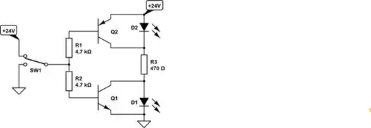

Figure 1. Current shunting the LEDs.
Rather than trying to switch the LEDs on under certain conditions it may be easier to switch the off by shunting the current around them. Can someone do a sanity check on this design?
How it works.
  • With SW1 high as shown, Q2 is biased off and Q1 is biased on shorting out D1. D2 will light.
  • With SW1 toggled, Q2 is biased on, shorting out D2, and Q1 biased off allowing D1 to light.
  • With SW in mid-position (disconnected) current will flow Q2e-b - R1 - R2 - Q1b-e, bias both transistors on and shunt both LEDs.
  • Current through R3 will be almost constant in the three states. With an LED on it will be \$ \frac {22}{470} = 47~\mathrm mA \$ rising slightly to \$ \frac {24}{470} = 51~\mathrm mA \$ when both LEDs are shunted.

  • Not the way that I'd do it but +1 for actually meeting the requirements of the original poster. – Dwayne Reid Sep 10 '16 at 13:30
  • @AndrewMorton: And the switch needs to have three positions, not two. An additional one for "unconnected." ;) – jonk Sep 10 '16 at 15:34
  • @AndrewMorton: Engineers usually can't spell. This one, apparently, can't count! Fixed, thanks. – Transistor Sep 10 '16 at 16:34
  • @jonk: "_With SW in mid-position (disconnected) ..._" was my attempt at making up for the limitations in the CircuitLab library. ;^) – Transistor Sep 10 '16 at 16:35
  • Thanks, @DwayneReid. What way _would_ you do it? – Transistor Sep 10 '16 at 16:37
  • LOL, not a "nice" circuit, but it does meet the specs, so can't really argue. You really should point out, though, that R3 will dissipate 1 W. – Olin Lathrop Sep 10 '16 at 22:21
  • This does not cut off base current in the open position, only cuts it 50% , sorry nice try. – Tony Stewart EE75 Sep 10 '16 at 23:35
  • @TonyStewart: I stated that both transistors would be on in my third bullet point. That's the working principle of this circuit since the transistors _shunt_ the LEDs and short them out. Are you still sorry? ;^) – Transistor Sep 11 '16 at 06:54
  • Oops.. ok you got my vote. But R3 1W fails the reality check problem with the question. – Tony Stewart EE75 Sep 11 '16 at 17:04
  • @Tony: Thanks. I agree that the big fat resistor doesn't look like a good idea but we probably don't have all the details of the application. We've seen worse around here! – Transistor Sep 11 '16 at 17:33

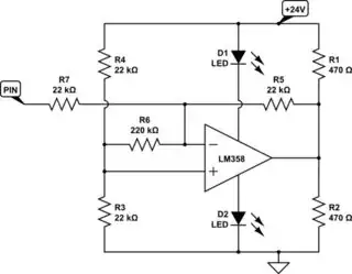

May as well add yet another random wag.
Per Transistor: ;)
Well, I figured that the opamp will have to source from its (+) rail when trying to pull its output up and will have to sink into its (-) rail when trying to pull its output down. I just made it so that in order to source from the (+) rail it has to pull that current through an LED and in order to sink into the (-) rail it has to sink that current through the other LED. I had to stick \$R_1\$ and \$R_2\$ at its output, too. The result is that the opamp will either (a) pull current through \$D_1\$ to sink into \$R_2\$, when hauling its output upward (lowering current in \$R_1\$ while increasing current in \$R_2\$), or else (b) sink current into \$D_2\$, sourced from \$R_1\$, when hauling its output downward (lowering current in \$R_2\$ while increasing current in \$R_1\$.) Well, there is case (c) where the PIN is left unconnected. Then the opamp will sink or source slightly different amounts through the diodes, but on the order of dozens of microamps in both cases so probably not visible.
jonk
  • 77,059
  • 73
  • 185
    I think this one gets the award for the screwiest, or cleverest abuse of a opamp. However, it is relying on unspecified behavior of the opamp. I've never seen a datasheet that promises what exactly the power and ground currents of a LM358 will be at different operating points. – Olin Lathrop Sep 10 '16 at 22:34
    Go on, Jonk. Add a little text. Nice idea. I'd forgotten this kind of trick. – Transistor Sep 10 '16 at 22:37
  • @OlinLathrop: I looked at the schematic for the LM358. I suppose they might redesign the thing. But I doubt it. – jonk Sep 10 '16 at 23:39
  • @Transistor: Done. – jonk Sep 10 '16 at 23:39
  • I remember having to design a complete op amp in 30 min. on a final exam, it has at least 20Q's – Tony Stewart EE75 Sep 10 '16 at 23:41
  • @TonyStewart: Yeah. That sounds about right. The diff pair alone can use (5)... the pair itself, plus another pair as a mirror in the collector legs to stiffen them, and a source or sink at their common emitter. I can easily see you getting to twenty. But in 30 minutes?? Wow. – jonk Sep 10 '16 at 23:50

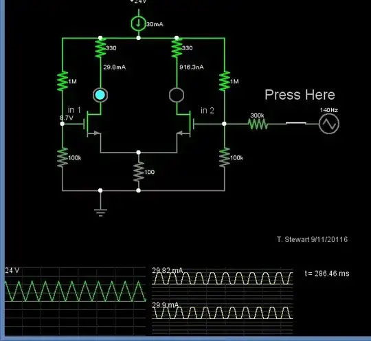

for something different for something different FETs ok ? I can use Darlingtons
  • This doesn't meet the spec since the LEDs don't go out when the input is left floating. If the left LED lights when the input is low, then both LEDs will share at least that current when the input is floating. – Olin Lathrop Sep 10 '16 at 22:40
    if the Vgs is chosen correctly , both are off., which is why I used 10:1 divider – Tony Stewart EE75 Sep 10 '16 at 22:45
