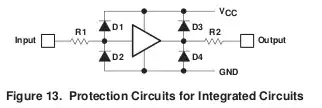

Texas Instruments
slya014a.pdf "3.7 External Protection Circuits", Fig. 13
Usually, there is no difficulty in choosing a suitable resistor for the input circuit. Resistor values of 1 kΩ to 10 kΩ usually are appropriate. In practice, it usually is adequate to use only a high-value resistor, without additional diodes.
TI-Fig13

You might want to consider something off-the-shelf, like a RS232 transceiver or receiver. Most will handle up to 25V (since RS232 spec is +/- 25V max) and some even higher voltages, plus you can get ones with 100% isolation to protect your circuit from ground-loops and other bad electrical issues.
Though RS232 is suppose to be +/- voltages, most modern RS232 chips consider a little bit above ground to be the threshold for a negative signal, thus your input should work with them. The reason this must work on RS232 chips is that a lot of bastardized RS232 outputs don't output +/-, but instead are positive signal or ground, thus modern RS232 chips must work with those types of signals. Check each datasheet for the threshold.
The logic-level signals that you get out will be inverted, but this shouldn't be of concern because you are measuring frequency.
+/-50V Isolated, 3.0V to 5.5V, 250kbps, 2 Tx/2 Rx, RS-232 Transceiver: http://www.maxim-ic.com/datasheet/index.mvp/id/3368
Various other RS232 chips: http://www.maxim-ic.com/products/protection/esd/rs232.cfm

You people with special issues with Body diodes or clamping diodes probably didn't have a large enough capacitor across the power supply close to the IC.
The diode is shunting the current to the +supply. If there isn't a big enough capacitor to absorb this it will cause problems. It is just the supply rail getting spiked up. Becuase you are using a rediulously small capacitor (0.1uF ?)
It has nothing to do with any mystery inside the silicon.
Just make sure you have a decent (10uF) cap near the chip Depending on how much current you are putting through the body diode/s.
10mA is fine. It is a diode.
I don't use external protection diodes. I use 2k7 resistors. You can connect 12 volts to the input of a 5V part, no problems. No worries. Try to understand what is actually happening before you start talking about floating fets and injecting currents into fairy land.
