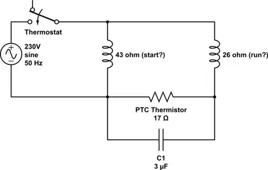

I have disassembled the motor controlling circuit for my refrigerator. I am trying to understand how it works, so I hopefully reduce the start surge-current and make it work with my 1000w inverter. Currently the fridge sometimes draws 1100w on start, othertimes only 600w.
The fridge is brand new, high-efficiency, "BEKO" with a Donper AG100CY1 compressor.
I've checked the circuit a hundred times, and it really is like this:
But it seems to go contrary to what I've read about refrigerator controller circuits.
  • The start winding is permanently connected (normally it would be disconnected after start, e.g. by a PTC)
  • The run winding is current runs via PTC at start, then via capacitor once hot
My main surprise is that the surprise winding is permanently connected.
(And additionally, I am hoping to add a start capacitor...)
Why isn't the start-winding disconnected? Does this make any sense?

That is a permanent split capacitor (PSC) motor.

  • Thanks. I was able to find a circuit diagram which seems to show the same... [link](http://www.electricneutron.com/wp-content/uploads/2011/03/run-capacitor-motor-circuit.jpg) – user95482301 Sep 08 '16 at 19:34
  • But where should I add the start capacitor to reduce start current then? At the voltage source? Or is it not possible to add a start capacitor to this type of motor? – user95482301 Sep 08 '16 at 19:36
  • http://www.industrial-electronics.com/image/p_split.gif – user95482301 Sep 08 '16 at 19:38
  • Or perhaps just add 20-100 ohm resistance in the first second and take it out with a relay? – user95482301 Sep 08 '16 at 19:41
Why did you check the circuit "a hundred times"? This is a technical site and "a hundred" means 100. ;^)
The 43 Ω winding is the primary one as it is directly across the mains.
The 26 Ω winding is the start winding as it has the series capacitor. I can't guess at the inductance but we could do some guesses about the currents.
The impedance of the capacitor is given by \$ Z = \frac {1}{2 \pi f C} \$. At 50 Hz this will be 1061 Ω and at 60 Hz 884 Ω. Worst case on 230 V 50 Hz is 230 mA and on 120 V is 135 mA. These seem a little low to me but maybe they're enough to give rotational torque to the motor to get it started but low enough not to waste significant power. The start winding does, after all, do some useful work even when up to speed.

  • Because I was so convinced that I was wrong, since the circuits I've seen explained all had a start capacitor with PTC. The PSC motor was new to me. – user95482301 Sep 08 '16 at 20:41
  • I've read that the start winding is generally the one with the higher resistance? The motor draws about 60w in operation, and 600-1100w at start. – user95482301 Sep 08 '16 at 20:45

That is a permanent split capacitor (PSC) motor. The starter wire in the case of an electromagnetic or electronic relay, which disconnects it after starting the engine, always has a greater resistance because it is built with a very thin wire, so as not to take up space, so that the aggregate comes out with the smallest possible dimensions . When the starting coil remains connected through the capacitor, a balance is found between the cross-section of the wire and the size of the capacitor, so that the current that will pass through it does not burn it. The currents at the beginning of the pump are the largest, not only from the moment of the start, but during the entire time that the refrigerator has a large evaporation of gas, which returns to the suction pipe of the compressor. when it reaches low temperatures, the compressor works more easily, because the amount of gas in suction is much lower. The refrigerators are built by groups of engineers and scientists in this field and they have found the balance of minimal electricity consumption. Your inventions will cost you enough to buy two new refrigerators and again you will achieve nothing.
