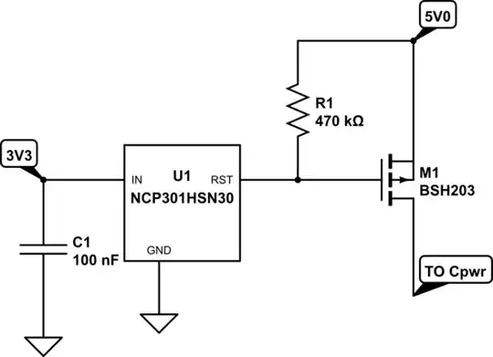

LTM4639 PGOOD Voltage Low out to Pch FET for high side switched 5Vout then choose "logic level" device with suitable low RdsOn.
This is easy with a NCP301H and a suitable FET (I spec the BSH203 here, but any logic level PMOS with Rds(on) less than 1 ohm at 4.5V Vgs will do), see below:
You should be able to use tiny passives here, too -- 0402 seems eminently feasible, and if your assembly process can handle it, 0201 is worth exploring.
