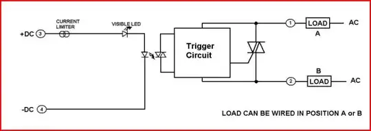

You say you followed Olin's circuit first, but then in the comments you say you tried Russell's circuit. Which one did you use for the relay?
I ask because the two circuits are different. Olin's circuit has the SSR input diode in series with the transistor (i.e. pin3 to V+ and pin 4 to collector) and is driven from the base. Russell's circuit has the input diode in parallel with the transistor (pin 3 to transistor collector and pin 4 to ground) and is driven from the emitter (common base)
Pinout of SSR for reference:
SSR
Assuming your GPIO current capability is really more than 100uA (very likely) then Olin's circuit should work if connected correctly.
One more important question - are you switching AC od DC with the relay?
EDIT - thanks for the schematic. According to that you have it wired incorrectly as suspected. Have a look at Olin's schematic again, notice the SSR is between V+ and transistor collector, not V+ and ground. Make changes as suggested and it should work fine.

  • Oh shoot. Why the hell did I connect it to ground? Been thinking too much I/O lately. Thanks a million for noticing! – jfax Jan 25 '12 at 21:26
  • However, when getting that part right, I can only measure 1.3uA from the GPIO port and barely 0.1uA for the relay when the GPIO is high. Relay's still not lighting up... – jfax Jan 25 '12 at 23:35
  • Sounds like there is something up with your GPIO port then. Are you sure it's set to output and not something like input with weak pullup? To confirm it's not your transistor setup, apply a known 1.8V source to the gate and see if it turns on. – Oli Glaser Jan 25 '12 at 23:39
