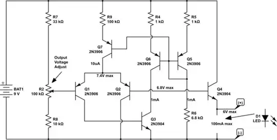

But let's say you really do want to set up some fancy voltage regulator for your \$9V\$ battery. (Instead of doing the sensible thing about setting up the current, instead.) You can try this. Just use a \$100\Omega\$ resistor where the LED goes, at first, and adjust \$R_2\$ until you measure a voltage across the \$100\Omega\$ resistor that you like (as shown, where the (-) and (+) appear in the schematic and where you place your voltmeter for measuring.) Then you can replace it with the LED and see how that goes.
You can play with the potentiometer, \$R_2\$, to then adjust the voltage at your LED. Should only waste an excess of \$2mA\$, regardless of the set voltage. The maximum output voltage will be \$6V\$ with a current compliance of up to \$100mA\$. (\$Q_4\$ may need to be a TO-220 packaged type, just in case.) The problem will be that you will have a very hard time adjusting the potentiometer without having a serious impact on the LED brightness. But it can be a learning experience.
Or you could just use a variable voltage regulator IC.
