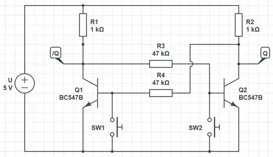

Here's a circuit diagram of a simple latch. I used the same transistors that are shown in the diagram:
enter image description here When building this circuit on a breadboard (with an additional LED before the 1k resistor), I found that always the same LED was lit when switching it on. This is due to the tolerances in the electronic parts: one transistors is never like the other. It switches a little bit faster or slower, so the whole circuit has a favorite initial state, that it falls into at power-up.

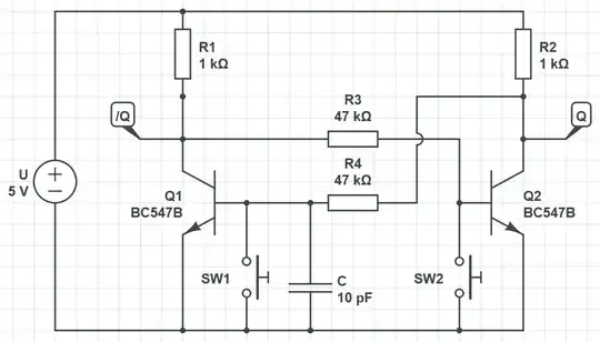

  • put a small capacitor to one transistor base, one side connected to the transistor base and the other side connected to ground.
I tried 1uF first, and it worked perfectly. Then I went down to 10nF and further down to 100pF and 10pF, and it still worked. It even worked 90% of the time with 1pF.
enter image description here It works because the capacitor short-circuits the connected transistor base (Q1) to ground for a very short time until the capacitor is charged... would be charged. "would be", because this short moment is enough for the other transistor Q2 to switch on, and once Q2 is on, the base of Q1 is connected to ground, so Q1 will remain off until someone pushes SW2. When SW2 is pushed, the capacitor gets charged and when finished Q1 is switched on.
For a safe long-term usage you may want to add a small resistor (like 10R) in row with the capacitor to avoid high currents when it is discharged.

Oben ist ein Schaltplan einer einfachen Kippstufe abgebildet. Ich habe in meiner Schaltung dieselben Transistoren wie im Schaltplan verwendet.
[ BILD 1 ]
Als ich diese Schaltung auf einer Steckplatine aufgebaut habe (mit zusätzlicher LED vor dem 1k-Widerstand), habe ich festgestellt, dass stets dieselbe LED beim Einschalten geleuchtet hat. Das liegt an den Toleranzen in den elektronischen Bauteilen: Kein Transistor ist wieder der andere. Einer schaltet schneller oder langsamer, wodurch die gesamte Schaltung einen bevorzugten Zustand hat, den sie nach dem Einschalten einnimmt.

  • einen kleinen Kondensator vor einer Transistorbasis hinzufügen, eine Seite verbunden mit der Transistorbasis und die andere mit Masse.
Ich hab zuerst 1uF ausprobiert und es hat perfekt funktioniert. Dann hab ich kleinere Werte verwendet, erst 10nF, dann 100pF und 10pF, und es funktionierte immer noch. Es funktionierte sogar in 90% der Fälle noch mit 1pF.
[BILD 2]
Es funktioniert, weil der Kondensator kurzzeitig die Basis von Transistor Q1 mit Masse kurzschließt, bis der Kondensator aufgeladen ist... aufgeladen wäre. "Wäre", weil dieser kurze Moment ausreicht, damit der Transistor Q2 durchschaltet, und sobald dieser durchgeschaltet hat, ist die Basis von Q1 mit Masse verbunden und Q1 bleibt aus, bis jemand SW2 betätigt. Wenn SW2 gedrückt wird, wird der Kondensator geladen und sofort danach Q1 durchgeschaltet.
Für eine sichere Langzeitanwendung ist es empfehlenswert, einen kleinen Widerstand (z.B. 10R) in Reihe mit dem Kondensator zu schalten, um hohe Entladeströme zu vermeiden.
