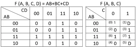

Edit: While I understood the accepted answer and it is the correct answer, I was then required to use just the following inputs for the data lines of my 2:1 muxes: logic 0, logic 1 and the variable D. The variables A, B, C should only be used as selector lines.
I created the V-K Map for F(A, B, C, D) = AB + BC + CD and I then used that map to derive a V-K map for F(A, B, C) as can be seen below.
enter image description here Edit: for the map on the right the value for ABC = 000 should be 0, not 1. A mistake I made when I copied over the table from my notebook into excel.

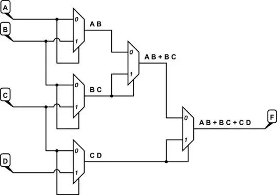

It's not too complex, I think, assuming you worked out the equation you wanted correctly (I'll assume you did okay there.) Start by looking at the equation for a 2-in MUX:
$$ \begin{align*} M_2(A,B,S) &= A\cdot \bar{S} + B\cdot S \end{align*} $$
From this, you can derive some useful results:
$$ \begin{align*} M_2(0,x,y) &= x\cdot y \\ M_2(x,0,y) &= x\cdot\bar{y} \\ M_2(x,y,0) &= x \\ M_2(1,x,y) &= x + \bar{y} \\ M_2(x,1,y) &= x + y \\ M_2(x,y,1) &= y \\ M_2(x,y,x) &= x\cdot y \\ M_2(x,y,y) &= x + y \\ M_2(0,0,x) &= 0 \\ M_2(0,1,x) &= x \\ M_2(1,0,x) &= \bar{x} \\ M_2(1,1,x) &= 1 \end{align*} $$
So it follows that:
$$ \begin{align*} F &= A B + B C + C D \\ x &= A B = M_2(A,B,A) \\ y &= B C = M_2(B,C,B) \\ z &= C D = M_2(C,D,C) \\ \therefore F &= x + y + z \\ F &= M_2(M_2(x,y,y),z,z) \end{align*} $$
In short, you will need (5) 2-in muxes:
There's also a nice symmetry there. Notice it?
ADDED: You asked about only being able to use 0, 1, or D as a mux data input source. I assume by this that you mean that all of A, B, C, and D can be used as mux selectors. (Otherwise, I don't think the result can be achieved.) So, this just means you need to use some of the other useful results I'd earlier mentioned. The simplest idea would be to just add three more 2-in muxes:
simulate this circuit
I'm not sure if there is a way to optimize it further. I haven't examined all of the possibilities.
EDIT AGAIN: Yes! Using the OP's newly added solution, the following two just flow out. The left one answers his first part of the question, the right one answers his second part.
EDIT AGAIN AGAIN: The ordering isn't complicated. It's just assigning the letters where they belong. The author took (A) to be the high order bit of a three-bit binary value, so it represents either \$0\cdot 2^2=0\$ or \$1\cdot 2^2=4\$; took (B) to be the middle bit of a three-bit binary value, so it represents either \$0\cdot 2^1=0\$ or \$1\cdot 2^1=2\$; and took (C) to be the low order bit of a three-bit binary value, so it represents either \$0\cdot 2^0=0\$ or \$1\cdot 2^0=1\$. A variety of different perspectives would work equally well. But that's the one they appear to have chosen.
So they now started with the first (left) tier, laid out (4) muxes controlled by (A), and stayed mentally convenient by numbering those muxes as ABC="x00", ABC="x01", ABC="x10", and for the bottom one ABC="x11".
Now, since for the top one, ABC="x00", this means that it accepts either "000"=0 or "100"=4. So for the "0" input of that mux (mux1), they looked into the table for ABC="000"=0 and placed the table entry into its "0" side input. For the "1" input of that mux, they looked into the table for ABC="100"=4 and placed that table entry into its "1" side input. (That table looks wrong here, as their should be a 0 in that box, confirmed by looking at the earlier expanded columns.)
The next mux down (mux2) is for ABC="x10" and therefore used ABC="010"=2 and ABC="110"=6; the next mux down (mux3) is for ABC="x01" and therefore used ABC="001"=1 and ABC="101"=5; and finally the last mux down (mux4) is for ABC="x11" and therefore used ABC="011"=3 and ABC="111"=7.
Both mux1 (ABC="x00") and mux2 (ABC="x10") are jointly fed to mux5. You can see here that B is the variation between these, 0 or 1, so that's how they hooked them up here. The output of mux5 will be ABC="xy0", where the first two bits have already been decoded and all that remains is to decode the C=0 situation. So the output of mux5 goes to the "0" input of mux7. Similarly, mux3 (ABC="x01") and mux4 (ABC="x11") are jointly fed to mux6. B again being the variation that mux6 selects between. The output of mux6 is always related to the C=1 case, and that is fed into the "1" input of mux7.
All that remains is for mux7 to pick between C=0 and C=1.
