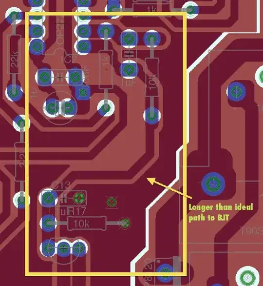

Alright so I redesigned the board. I was able to keep all but one trace in the bottom plane. The is also a trench separating some of the high current traces from the control circuit. enter image description here
I am using both a top and bottom ground plane pour because this board will be made on copper clad; through hole components mounted on top can only be soldered (well) on the bottom layer. Now, this creates ground islands in the bottom layer. I tried to place the vias close to were the components terminate so the ground return path would not be altered that much.
One concern I have is that one of the traces to a BJT base is longer than I want... High input impendence makes it vulnerable to noise. I don't have enough experience making boards to know if this is bad design or not ( shown bellow) enter image description here

    Much depends on details. In general, I avoid star-point returns as they can cause more problems than they solve in some circumstances. http://electronics.stackexchange.com/questions/185306/analog-power-ground-planes-doubts/185320#185320 If you add the schematic, the context will be clearer. – Peter Smith Sep 05 '16 at 06:48
  • Personally, I never split ground planes because it tends to create radiated emissions problems. It can also make noise problems worse if implemented poorly. The important thing to understand is how current flows on the ground plane, and avoid placing or routing sensitive analog signals near where high currents are flowing. Note that "sensitive" means high impedance and/or high gain. If the impedance is low, or there is no gain applied, it may not be a "sensitive" signal. Even a mV shunt signal is not THAT sensitive. – user57037 Sep 05 '16 at 17:15
    OK, this is what I am confused about: should I 'control' the ground return paths with routing rather just terminating everything directly into the ground plane. Do currents terminated in the ground plane diffuse in the plane or just find shortest distance to the power supply ground connection? – Tony Sep 05 '16 at 23:54
  • Current finds the lowest impedance return path. But where is it returning to? That is what you have to understand. Digital signals routed over a ground plane will have high current density in the ground plane near the trace. The current density falls off as you move away. Switch mode supplies have high current density from input cap to inductor to output cap and also through diode, if any. Motors with any form of PWM control can cause large currents to flow. But I feel that analyzing that current path is fairly straightforward. This question is asked often here. Search for other answers. – user57037 Sep 06 '16 at 03:28
    In general, you want to control currents by providing them an easy way to go where they want (low impedance). NOT by trying to prevent them from going where they want (which increases impedance). And then avoid routing victim signals in places where rapidly changing voltage and current are present. – user57037 Sep 06 '16 at 03:30
