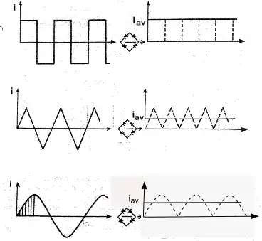

Rectifying square wave voltage seems to give us DC directly without the need of a capacitor. so, why do we prefer sine wave over it?
What would change if I powered any adapter (laptop adapter as example) or any power supply with a square wave inverter instead of sine wave?
Edit: I understood from answers and comments that sine wave is better at generating and transmission, let's consider this a special case about "Powering power supplys (with input rectification) with inverters."
