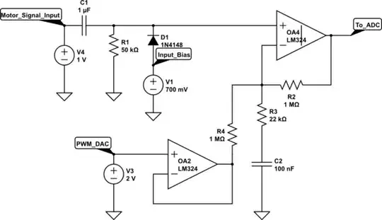

My current attempt to solve this issue is to use the PWM signal used to drive the motor as a means of adjusting gain on a separate gain only amp. The gain is set to put the high duty signal at the desired Vpp. As the duty increases and inverted copy of the duty is filtered into an analog signal (represented by V3) and fed through a voltage follower connected to the inverting pin on the amp with the gain stage. But when I do this, the DC outputted in step 5 causes the signal to saturate at the op amp's upper rail when low duties are used. If I put a diode clamp between the signal from step 5 and the gain only amp, I can control the gain as I had hoped. When I put a capacitor between the gain resistor attached to ground and ground to reduce DC gain to unity and eliminate the need for the diode clamp, the gain is no longer controlled and the DC gain isn't unity. The diode clamp needs to be replaced since the various Vpp values need different offsets so they won't saturate.
Here's that last paragraph as a schematic. The op-amps are LMV344 op-amps, not LMV324 as the illustration suggests. The input signal has a Vpp from 30mV to 4.7V depending on the motor duty.

How can I get a variable gain circuit, amplify signals with Vpp between 30mV and 4.7V to around 4.7V, while avoiding saturation due to input DC levels? Thank you in advance. This has consumed me for the past month.
