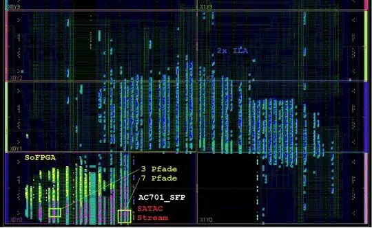

This images show the normal design flow. The ILA cores are far away from the SATAController (SATAC) and the 8-bit CPU (SoFPGA), but the controller still has failing paths (that's the only region with failing paths).
It feels like the Artix-7 is out of routing resources in some areas. How can I get a report indicating such a suspicion?

Here is a heat map of all negative slack values per Slice (colored in red) enter image description here

  • @TomCarpenter The placement constraints are called PBlock :). As far as I can tell, there are no ILA cells in the SoFPGA or SATAC region, they are separated through 3 FF stages on each of the 151 trace signals. The probed design runs in the same clock domain as the ILA (150 MHz). All paths are constrained (no unconstrained, no failing inter-clock paths). The mentioned failing paths are all in the same clock domain, either in the SATAC or in the ILA itself. I found a routing congestion report, which says circa 54 % usage (hor. and vert.). Please see my neg. slack heat map added to my question. – Paebbels Aug 31 '16 at 12:28
    I found 2 issues: At first, the Artix-7 is 15 to 50 % slower than a Kintex-7. If I change the default speed grade from -2 to -3 all is fine (there is a safety margin of 200 ps compared to 670 ps neg. slack. So the speed grade -3 improves a 6.600 ns path by almost 0.970 ns! It seems as if the pure attachment of trace signals causes a higher fan out, which causes timing problems. Additionally, the trace routes go through the 100 MHz clock domain for the 8-bit CPU, which in turn causes (one out of 5 runs) issues in that clock domain. So long lines / route throughs cause issues on other lines. – Paebbels Aug 31 '16 at 12:37
