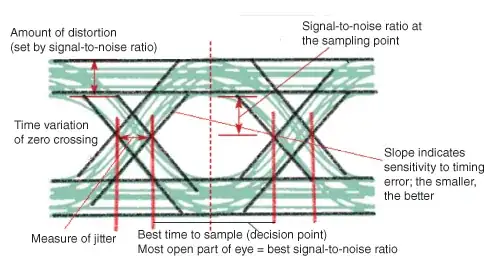

I suggest you use an oscilloscope to look at the eye diagram, this will help reveal the specific problem with your received signal.
