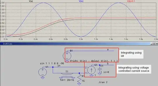

Without stealing @FakeMoustache's suggestion (and since the OP didn't specify), I'll just add, along his lines, that definite integration (the basic moving-average) is also possible:
![comparison
Here, integration from 0 to 1 for a 1Hz raised cosine. Note that V(b) is plotted with a 0.1V DC offset, for better comparison. As seen, both methods yield the same result (V(a) and V(b)).
Despite the larger number of elements and nodes, the second suggestion may come faster and more orecise, as the tline has a fixed delay that is not dependent on the sampling rate (i.e. the simulation timestep). Of course, given the conditions, a simple behavioural source may be more convenient -- this is, entirely, a user's choice.
