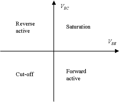

There is a precise definition and a sloppy one for saturation. I'll start with the precise one.
That's pretty much it. The saturation region is precisely defined here.
The sloppy one comes about because the practical behavior of different parameters of the BJT don't all neatly fall so perfectly on those lines. Besides, those voltages aren't the only thing that is important. Temperature certainly has a large effect on some parameters, so you could imagine extending a 3rd axis, in and out of the paper here, to add in that dimension. And then mapping the practical details onto that new view would be even more complex.
The sloppy idea of saturation is a practical one. If you are considering operating the BJT as a switch, you have already made the decision to operate in some part of the saturation region in the chart. But you also will be operating with a substantial forward biased \$V_{bc}\$ and not close to zero and certainly not reverse biased. This isn't a precise definition and different people will use different thresholds. So part of that region isn't useful. If you are considering operating the BJT as an amplifier, then you probably want to keep \$V_{bc}\$ reverse biased and perhaps add a small margin to that, as well. So once again, varying ideas of "out of saturation" will apply here for an amplifier. And once again, it doesn't fall precisely on the chart as shown.
EDIT: The distinction shown in the above chart is an arbitrary demarcation using the difference value of \$0V\$ as the place to draw lines, but it is also an objective, measurable, quantitative, and exact one. Whether or not it is a physical one depends on the physical parameters you care about, I suppose. But if you seek some physical point of demarcation, such as was found for Pluto vs the other planets where 5 orders of magnitude in natural demarcation was found based upon some well-reasoned physical ideas, then we'd have to get into a discussion about what physical ideas you think are appropriate. Only then could anyone attempt to decide about where these points of demarcation occur. And I don't believe that kind of discussion is appropriate here.
For the seminal paper which provides the mathematical models and expresses them using exactly the two axes I show above, see: J. J. Ebers and J. L. Moll, "Large-Signal Behavior of Junction Transistors," Proc. IRE, Vol. 42, pp. 1761-1772, December 1954. The earliest publication I happen to have on the shelf, showing the above chart, is "Modeling the Bipolar Transistor," by Ian Getreu, 1976. It appears in the first few pages of the book. His book was the result of his working at Tektronix in their STS (semiconductor test systems) group in the late 1960's and early 1970's and was initially published by Tektronix. It is currently available via Lulu.
If you want to see the original Ebers-Moll equations, which use \$V_{bc}\$ and \$V_{be}\$, then I conveniently posted them here, "Why is Vbc absent from bjt equations?," as a response to that question. You don't have to go back to the original paper if such a summary is okay. Also, if your question is an historical one, I could attempt to re-contact Ian and see if he remembers where he got his chart. He may recall.
EDIT AGAIN: I'm adding a chart taken from a 1979 edition of Jacob Millman's "Microelectronics: Digital and Analog Circuits and Systems." This is from the top of page 61, Section 3-2:
Page 61, Section 3-2, Jacob Millman, "Microelectronics," 1979
Hopefully, that helps more. Such a chart should be readily available in nearly any introduction text on semiconductors.

  • Reference, please? Not en.wikipedia, of course. – Incnis Mrsi Aug 26 '16 at 22:01
    @IncnisMrsi: The reference here is: J. J. Ebers and J. L. Moll, "Large-Signal Behavior of Junction Transistors," Proc. IRE, Vol. 42, pp. 1761-1772, December 1954. – jonk Aug 26 '16 at 22:34
  • 1954, are you serious? Only three years after their production started, whereas it’s a mature technology by now. – Incnis Mrsi Aug 26 '16 at 22:37
  • @IncnisMrsi: That's where the math comes from. If you want the chart itself, it comes from Ian Getreu's "Modeling the Bipolar Transistor," with a first printing in 1976. – jonk Aug 26 '16 at 22:39
  • The chart doesn’t add anything to the en.Wikipedia table. – Incnis Mrsi Aug 26 '16 at 22:40
  • Such transistor-as-a-switch stuff as http://www.faqs.org/docs/electric/Semi/SEMI_4.html doesn’t require the collector junction to become forward biased. Assuming the load a resistor, B–C will have reverse bias unless the input voltage exceeds the voltage of the power source (that is unlikely in practice). Ī̲ don’t understand what are you speaking about. – Incnis Mrsi Aug 26 '16 at 23:02
    @IncnisMrsi: I probably can't help you trace things. If this is a serious historical question and you want something that is well-researched, I can only help by contacting Ian (I know him) and asking him where he got his chart for his book back in the mid 1970's. But this is way out of my pay grade, if so. Otherwise, I honestly can't seem to figure out what you want to know. – jonk Aug 26 '16 at 23:05
    @IncnisMrsi: Regarding your comment about \$V_{bc}\$ not being forward biased when the BJT is used as a switch, I'm not going to belabor this because I'm not going to go argue with a web page. If you like the page, that's fine. But I've no need to go look at it or care. I was speaking accurately, regardless. (A BJT does, or used to have symmetries [see the reverse active region], so the he-says, she-says argument could spend way too much time working over the meaning of meaningless words.) – jonk Aug 26 '16 at 23:11
    @jonk: I am also confused about his very skeptical mindset as well. There is nothing mysterious about BJT fundamentals. It was pretty much fully understood just a couple years after it was built. There are two diodes in the BJT. Just like the diagram he shows (where the origin is really around 0.6V imo), there are four possible combinations for these two diodes when broken into on or off. The only reason the Vce saturation voltage is not 0V is because they dope the emitter more heavily than the collector, so it comes out to be ~0.2V usually. – jbord39 Aug 27 '16 at 00:28
  • @jbord39: I have only two remaining ideas about it: (1) He wants an historical viewpoint. I can help only a tiny bit here, by asking an old author who may be able to help a little. (2) He wants a physical meaning, based upon some clear, naturally occurring point of demarcation with perhaps orders of magnitude of some measurable separating one bunched grouping from another. Other than that, he's not clearly expressing his question to me. And even then I'm being forced to guess. The distinction I posted is an arbitrary demarcation. But at least it is objective and measurable and theoretical. – jonk Aug 27 '16 at 01:51
  • Ī̲ don’t ask for precise mathematics, only demand to look at (qualitative) physical sense, such as signs of all 3 currents. Nevertheless, the answer is now good enough to deserve upvote. – Incnis Mrsi Aug 27 '16 at 19:56
  • @IncnisMrsi: (I read the rest of your recent note before re-editing and accept your position. It's entirely your own business.) I will add a chart with the currents shown. You could just as well have looked up something similar in most any book. But I just scanned this in and will add it for completeness. It may not change any of your mind. But it's worth adding, regardless, I think. – jonk Aug 27 '16 at 20:14
  • @IncnisMrsi: Hopefully, that helps. If not, we have to part company and consider the exchange complete, regardless. – jonk Aug 27 '16 at 20:27
  • jbord39, regarding (quote) "there is nothing mysterious about BJT fundamentals" do you know the interesting historical aspects which can be found here: http://ieeexplore.ieee.org/stamp/stamp.jsp?arnumber=775421 ? (In particular, on page 1387). – LvW Aug 28 '16 at 08:45
  • @LvW: For sure, it was very mysterious as it was being discovered. But TODAY the operation is well understood. That is why they are called "fundamentals" – jbord39 Aug 29 '16 at 20:24
  • jbord39, agreed - today it is (better: should be) well understood. But such historical aspects can explain the surprising differences (contradictions?) which still can be found between the various textbooks. – LvW Aug 30 '16 at 07:33
