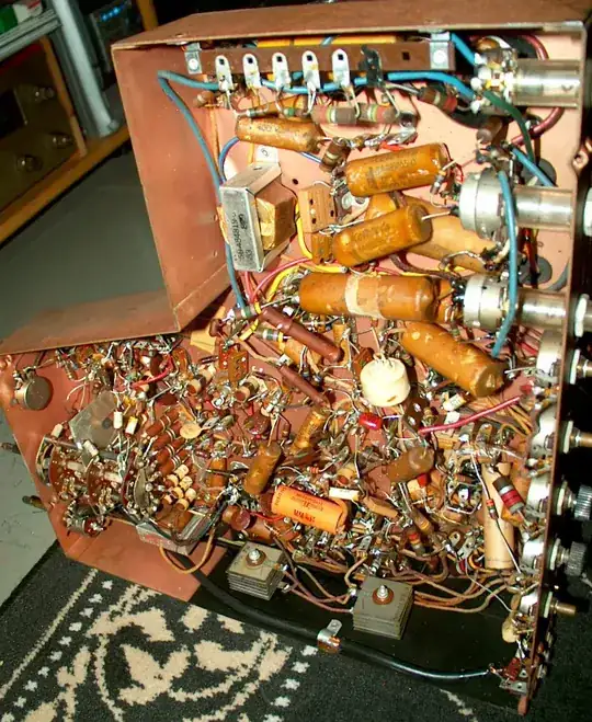

It's worth noting that older TV's were constructed with point-to-point electronics soldered by hand, lacking a firm place for the components to be anchored to, such as this image showing the underside of the chassis of a 1948 Motorola VT-71 7" television.
Point-to-point wiring (image taken from the wikipedia page for Point-to-point construction)
From the image alone it is clear why a solid whack to the box could provide enough energy to move loose components and bring them to rest in such a state they go back to working correctly. It could be down to exposed conductors touching, or a poor solder joint being loose and the movement provided from a solid hit moves the offending components back into a position that they work again - by either breaking connections that shouldn't be connected, or by doing the opposite to the components that should be connected.

    It would be a good idea to provide credit to the author of the photograph, including a link to the source. Doing so may be a copyright requirement for use of the image. – Makyen Aug 25 '16 at 10:48
    What a mess!!! I'm surprised they were able to keep those exposed wires from shorting to each other on a very regular basis (if not constantly). I barely see any insulated wires – jbord39 Aug 25 '16 at 13:47
    @jbord39: That's because there are very few wires there. What you're seeing are the bare component legs. It was common to have screwdrivers with insulated shafts for adjusting trimmer caps and chokes in such sets, to avoid shorting things out. – TMN Aug 25 '16 at 14:26
    @jbord39 It only looks like a mess to the untrained eye. With proper layout (as we see here) the component leads do not touch one another. They are short, stiff, and soldered to numerous fixed contact lugs. If you look closely you will see that in a few places where a component has more freedom of movement an insulating sleeve has been slipped over a lead. Because everything is open and visible working on these things is a real joy, at bit like working on an old pickup truck as compared to a modern compact car. – David42 Aug 25 '16 at 16:43
    manufacturing these must have been such an ordeal! On comparably complex manually assembled PCBs, you'd have silk screen to tell the assembly line worker exactly where that resistor had to go – I can only imagine people having a printout of a plan, highlighting the components they ought to solder into place in their manufacturing step, sitting in front of a sorted box of components and praying they don't accidentally mix up these two solder lugs in the lower right corner at each of which 8 component leads end.. – Marcus Müller Aug 27 '16 at 07:34
    This kind of chaos wiring seems to be coming back in under the name "Manhattan Style". We may be living in a temporary period in which we have been blessed by organised, thoughtfully designed PCBs. – Ian Bland Sep 28 '16 at 11:24
  • @IanBland Personally I cant imagine organised and well laid about PCBs being replaced for anything but for prototypes, one-offs and extremely low volume production runs. Especially in high-frequency applications, the cons of this style _far_ outweigh any pros – James T Sep 28 '16 at 11:39
