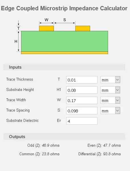

Using the EEWeb Microscrip Impedance Calculator, I find that with 1oz/ft^2 copper and a substrate height of 0.08mm, my trace width should be 0.17mm in order to achieve this 45 ohms.
The Fairchild application note also says that the differential characteristic impedance of the D+ and D- lines should be 90 ohms.
Using the EEWeb Edge Coupled Microstrip Impedance Calculator, I find that the spacing between my traces should be 0.098mm in order to achieve this.
Does that look right?

question 1: This doesn't seem right enter image description here
The default Er is 4, but usually the ER for standard FR4 is around 4.6. Although for this calculation you will need the effective Er because the top of the trace is not embedded in FR4.

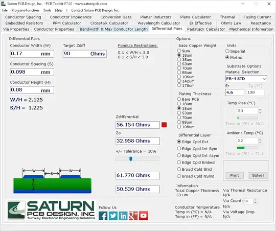

with Er=4.6, conductor with=0.17mm and dielectric height of 0.08mm the effective Er is 3.2215. but the EEWeb Edge Coupled Microstrip Impedance Calculator not giving me the same values as the polar si800 field solver or the free Saturn PCB toolkit. enter image description here
use the Saturn PCB toolkit it is free and it alco can compensate for the plating trapezoid shape of the traces and other production process variables.

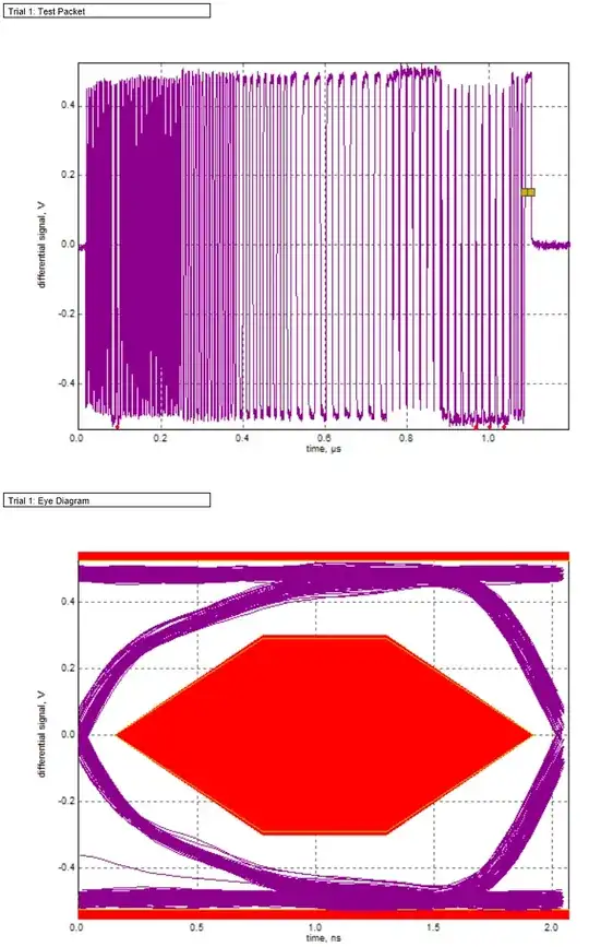

As a example of using the series resistors to improve compliance please see the following picture. Although the eye diagram perfect, the teat packet failed because it went over the boundaries as signaled by the 3 red dots in the bottom right of the template boundary box. this is because there is some overshooting. The series resistors can be used in this case to reduce the overshooting. enter image description here
the test passes after increasing the series resistor value by 10 ohms.
