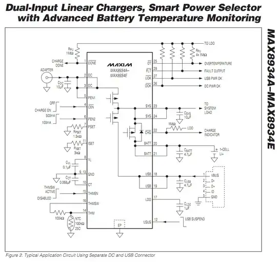

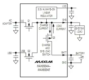

    Various manufacturers make single IC LiIon / Lipo chargers that need no external transistors to function. One sich is Maxim's MAX8=8934A / 8934E. This is not necessarily the best solution available, but is very flexible and very competent. It allows USB or mains (via power pack) input, charge and discharge control, low power inbuilt LDO 3V3 regulator and much more. Cost is about $US5.20 /1 from Digikey in stock. This is about 4 x the complete parts cost of my "simplest possible" solution below - but it is far more capable. It's in a beginner unfriendly 28 pin TQFN package.
    Datasheet
    Pricing
    A typical circuit diagram is provided at the end of this post.
    Block diagram only:

MAX8934x typical circuit diagram.

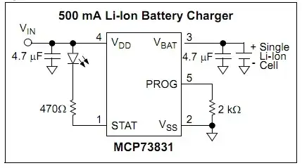

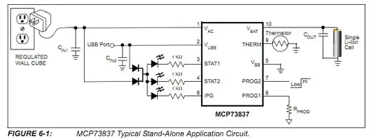

Microchip do a number of li-poly charger ICs - the datasheets & appnotes for these would be a good start. For example, the MCP73837.
Microchip MCP73837 / 73838 single IC charger datasheet.
Or the even simpler 500 mA capable MCP73831 which cost about 70 cents and are in a small but almost beginner friendly 5 pin SOT23 package.
http://ww1.microchip.com/downloads/en/DeviceDoc/21984E.pdf
