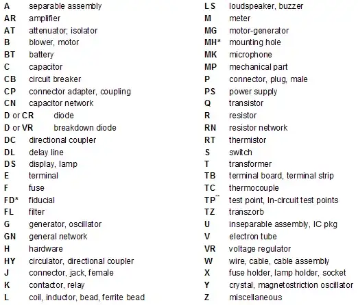

The standard which I think is most commonly used for symbols/reference designators is ANSI/IEEE Std 315 (1975). It has been revised a couple of times since but the basics have remained pretty much the same.

I have a copy here on my machine, here is an example of the first few letters:
A
(see also U and 22.2.4)
electronic divider
electronic function generator (other
than rotating)
electronic multiplier
facsimile set
field-polarization amplitude
modulator
field-polarization rotator
general circuit element
gyroscope
integrator
positional servomechanism
sensor (transducer to electric
power)
separable assembly
separable subassembly
telephone set
telephone station
teleprinter
teletypewriter
AR
amplifier (other than rotating)
repeater
AT
bolometer
capacitive termination
fixed attenuator
inductive termination
isolator (nonreciprocal device)
pad
resistive termination
B
blowermotor
synchro
BT
barrier photocell
battery
battery cell
blocking layer cell
photovoltaic transducer
solar cell
C
capacitor bushing
capacitor

    A flag states that the answer has been downvoted because it's incomplete. I understand that you've not completed it because you're quoting this copyrighted work under the [Amount and Substantiality Fair Use exception](http://en.wikipedia.org/wiki/Fair_use#Amount_.26_substantiality). I'd upvoted you before the downvote or flag, your net rep is +18 for this answer. This, in my opinion, is the correct answer to the question. You might mention IEC 60617, but they're basically the same AFAIK. – Kevin Vermeer Jan 19 '12 at 23:34
    Ah, I see. As you guessed it's intentionally incomplete - I just quoted a small part to give an idea of the detail the standard goes into. – Oli Glaser Jan 19 '12 at 23:49

Yes, there is, but its not really a standard, everybody simply does it more or less the same way.
  • IC? stands for an IC
  • R? stands for a resistor
  • C? stands for a capacitor
these are the "names" of the component. the boardmaker then has a kind of list where is written what name stands for what component, e.g. R1 - Resistor, 100Ohms

    On all PCB I’ve seen, ICs are marked as U. – kinokijuf Jan 19 '12 at 14:37
  • well, as I said, there is no real standard. but yes, U is much more common – milch Jan 19 '12 at 14:42
    I can confirm, I hav a board in front on me with "IC"notation – clabacchio Jan 19 '12 at 14:45
  • I use 'IC' on my own boards. My PCB software uses 'U' by default, I keep meaning to change it. – Leon Heller Jan 19 '12 at 15:08
    I think that historically, 'IC' was/is found on British PCBs whilst 'U' is found on US boards. Likewise for transistors, 'Tr' used to be common in Britain but the American 'Q' designator has largely replaced it. – MikeJ-UK Jan 19 '12 at 16:45
    U is "undefined", which what got used for ICs when they first became available. They are common now, so it makes sense to give them their own designator. I use IC in all my schematics. – Olin Lathrop Jan 19 '12 at 17:44
  • It is really a standard, or rather a set of standards: IEC 60617 and ANSI standard Y32 (aka IEEE Std 315). See [Oli's answer](http://electronics.stackexchange.com/a/25323/857) for an excerpt. – Kevin Vermeer Jan 19 '12 at 19:28
