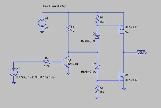

I'm designing charge pump based 24V to 144V converter for powering up my experimental tube amplifier. So I need a low impedance driver circuit with rail to rail output. Can you suggest me the best way to drive 24V from low voltage oscillator like NE555 (about 12V max) of even simple TTL Schmitt trigger oscillator (5V)? As far as I understand it can't be done with simple push-pull circuit.
UPD: I think this should work. I added two 10V Zeners to prevent short cut because 24/2-10 < Vth so it's impossible to open both transistors simultaneously.
Maybe there is a more simple solution? Possible solution

  • If you are designing this charge pump, can you share some of the details? Such as the peak and average current that will be drawn from the 144V plate voltage supply and what kind of variation you can tolerate on that supply? "Best" always "depends" on things. – jonk Aug 17 '16 at 22:04
  • I plan to use linear post regulation down to about 135V. Tube differential amplifier will draw about 5 mA. The amp itself works fine on simulation and the pump too (except driver). Nevertheless I think it's not a subject. My question is more general. I just want to know how to drive voltages higher than control voltage. – e_asphyx Aug 17 '16 at 22:46
  • Then in general the answer is a discontinuous boost topology, I think. And it's almost useless, because it's so general. A question comes in, in part, because you are looking at a multiplication factor of 6. And this impacts duty cycle and that has other implications. Current is important because that will relate to power and that relates to the inductor core design. – jonk Aug 17 '16 at 23:10
  • What does that feed into? (It seems to me like you may be headed in the wrong direction.) – jonk Aug 17 '16 at 23:22
  • It feeds the charge pump (VSW on schematic http://imgur.com/cWSimyr). All voltages, components and their values can be changed, I'm just experimenting. I'm taking into account boost topology too but charge pump looks more unusual and (possibly) produces less noise. – e_asphyx Aug 17 '16 at 23:32
  • I'm not sure how you expect the one to drive the other. Things are pretty far apart from where I'd expect you to be, if you are planning a tube circuit. For ideas (and not for a design), you might also look here: http://www.diyphysics.com/2012/02/10/universal-resonant-transformer-driver-high-voltage-flyback-driver/ . That is the driver for this: http://www.diyphysics.com/2012/02/09/d-i-y-250-kv-high-voltage-dc-power-supply-with-neat-trick-for-switching-polarity/ , which looks more like your linked example. But I also think you should at least investigate a more traditional approach. – jonk Aug 17 '16 at 23:56
  • Strange zener configuration. It may work fine but why not a normal gate-source zener instead? Also, 1 k pullup for M1 will limit the switching speed. How much depends on your transistor. Also, how about driving M1 from your 12 V 555 instead to avoid the problem in the first place? Cross conduction comes to mind too so a diode-resistor gate arrangement might be needed. – winny Sep 18 '16 at 13:16
  • The circuit you shown is close to the simplest you can do with discrete. One way to make it more robust and faster switching would be to replace your Q1-D1-D2 arrangement with a direct drive from the input pulse for the M1 gate, and capacitively couple the M2 gate. Some examples in the answers there: http://electronics.stackexchange.com/questions/241482/double-polarity-pulse-with-one-single-power-source-and-virtual-spdt-switch – dim Nov 17 '16 at 15:34
I'm going to take a shot at this, given no one else has bothered. It's not an area where I have much experience. But I do have a little bit. So I'll draw from that.
The Cockroft-Walton multiplier you are considering isn't the direction I'd go. But at least I understand why you are trying to use a \$24V\$ rail, instead of the \$12V\$ output of the 555. You use about half as many stages that way. But assuming you use a complete, well-designed push-pull stage at the end of the 555, you still will need something like 7 stages (one of them to cover the diode losses and your push-pull losses.) Not the 5 that you show. I think 7 may get you there. Also, your push-pull driver will have to source and sink some serious current as it charges up the capacitor chain. You may want to plan on \$5A-6A\$ peak in the early period, sink and source, for designing purposes -- though once everything is fired up it will be a lot less. Ripple at 5mA load is another issue to consider. I'm guessing each capacitor on the order of \$1\mu F\$ in the multiplier chain. Just thinking about the 7X staging more, I'm guessing that you will need about \$70mA\$ for perfect efficiency (\$7\cdot 2\cdot 5mA\$.) But due to losses then probably more like \$100mA-120mA\$ rms. Peak current, worse, of course. That's where I'd put my mind at before building something like this and finding out, anyway. Frequency will also matter a lot. For the above thinking about capacitor sizing, I just picked a \$200kHz\$ drive frequency for consideration. But that itself will take some care with the push-pull design. It's doable. But not trivially doable.

  • I still want to use charge pump for some aesthetic reason. I googled many different designs of output buffers. Finally I have found an idea of inverter with active pull up instead of push-pull. Pair of single BJTs doesn't provide enough current gain but Darlington pairs does. Also you gave me very good advise about speedup cap. http://imgur.com/L5xYjiF – e_asphyx Aug 26 '16 at 17:42
  • The amp itself: http://imgur.com/y9zVGJM Input differential amplifier was inspired by Cavalli's SOHA-II. The most interesting part is DC-coupling stage. Although I have never seen this design before, I think it must be invented many times before me. – e_asphyx Aug 26 '16 at 17:44
