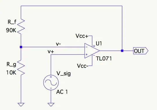

\$\beta\$ in known as the feedback fraction, (sometimes feedback factor), and is the proportion of the output voltage fed back to the inverting input.
Considering the non-inverting amplifier below, the fraction of \$V_{out}\$ that reaches the inverting input is readily determined to be \$1/10\$ by inspection of the voltage divider:
$$V_- = V_{out} \frac{R_g}{R_f + R_g}$$
$$\beta = \frac{V_-}{V_{out}} = \frac{R_g}{R_f + R_g} = \frac{10\mathrm{k}}{90\mathrm{k} + 10\mathrm{k}} = \frac{1}{10}$$
Returning to the formula we started with, \$A_o\$ stands for open-loop gain, about 100,000 in this case. Substituting into the formula, the gain is:
$$G = \frac{A_o}{1 + A_o\beta} = \frac{100,000}{1 + (100,000\cdot \frac{1}{10})} = \frac{100,000}{10,001} = 9.999$$
Which is awfully darned close to \$10\$, which is why we usually drop the \$1 +\$ bit and just say \$G = 1/\beta\$. This is what a simulation predicts and is very close to what is observed on the bench. So far, so good.

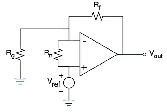

Ok, so maybe I was wrong? This all seems to work just fine. Hmm, what if we make a little tweak to the circuit. Let's pop in this innocent-looking resistor \$R_n\$:
And take a look at the gain over frequency again:
Whoa! What's up with that?
  • The closed loop signal gain (purple trace) is still 10 (20dB)
  • but it's bandwidth is reduced by a further decade, down to 43.6 kHz!
  • There's a cyan trace that bumps into \$A_o\$ in the right way, but it's up at 40dB

  • The cyan trace above is the noise gain (actually, it's only where it would be if I was able to plot it with SPICE). I was able to find a handful of references after extensive online searching, but no description of how to determine it when it's not the same as the signal gain. In the second circuit above, it value is:
    $$\frac{R_f}{R_g\parallel R_n}$$
  • Noise gain is what actually determines the frequency response, not signal gain. Noise gain is what SPICE (and your circuit) use to determine frequency response on an AC analysis.
  • Loop gain is (\$A_o\beta\$) and determines amplifier stability. But the \$\beta\$ in that expression is the noise beta (1/noise-gain), not the signal beta. Note that I've never seen either the term noise beta or signal beta in print, I've just invented (or perhaps reinvented) them here to distinguish the two.
  • As demonstrated above, noise gain can be manipulated without changing the signal gain. This turns out to be a very powerful way to tune in the bandwidth of an amplifier to get just the phase margin you want without monkeying around with the signal gain your circuit needs.

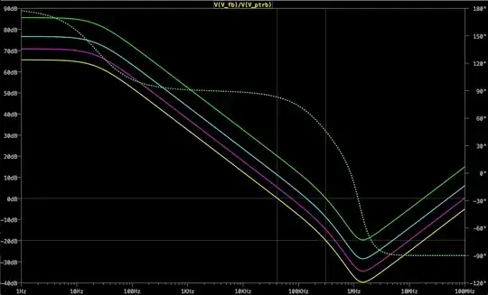

Let's take a look at the loop gain, where the stability of the circuit is determined. I'll substitute in \$R_n\$ values of 1k (as just above), 2k, 5k, and 100Meg (like no resistor at all). I added a 5 nF capacitor across the output to reduce the uncompensated circuit to 45 degrees phase margin:
I'll just jump to the punch line here. By adjusting \$R_n\$, I can manipulate the phase margin between wherever it is (46° in this case) and 90° and anywhere I want in-between. This comes at the cost of bandwidth, so it's not an entirely free lunch, but it allows me to optimize that trade-off wherever I want. This translates into the ability to tune my step response between the yellow and purple traces below:

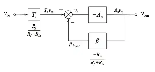

I think a block diagram view shows this most clearly. It's probably not strictly necessary for understanding this simple non-inverting case, but I found it crucial for understanding the general case. Also, \$\beta\$ is a block diagram variable, so we can avoid repeated mental block-to-circuit translations if we stay in the block diagram domain when we use it for reasoning.
The \$+\$ node on the summing block corresponds to the non-inverting input of the op amp (in this case, but not in general as we'll see below). It's easy to see there's no difference between a noise signal and a "real" signal applied there and the noise gain in this case is:
$$ NG = \frac{A_o}{1 + A_o\beta} $$
Now, in his book, Walter Jung defines noise gain as \$1/\beta\$. And, I expect we all know that the equation just above is approximately \$1/\beta\$ when \$A_o\beta \gg 1\$. In fact, this approximation is great for getting the DC noise gain, the Y-axis position of the long flat part at the beginning of its magnitude curve on the Bode chart. But if you want to see its frequency dependent behavior (for example, to plot it in SPICE), you need to use the long form.
Ok, so we're well on our way to how to calculate noise gain in the general case, but one challenge remains: How do we determine the value of beta (\$\beta\$)? It might not be obvious at first, but this is a challenge because the components that contribute to beta may also contribute to other blocks. There's no guarantee the feedback network has them all to itself; in fact, we need look no further than the inverting amplifier configuration for an example of them being "shared" (perhaps more precisely, interdependent).
Consider the inverting amplifier circuit below:
The block diagram for this circuit turns out to be this:
I won't go through the details of how you get here from the circuit diagram, but that might make an interesting follow-on question if you wanted to post it. Basically you create a Thevenin equivalent looking into \$R_f\$ from the inverting terminal and then use superposition to get the two contributions to the summing node. Note that here, \$V_e\$ represents \$V_- - V_+\$ at the op amp inputs, which is why \$A_o\$ and \$\beta\$ have minus signs in their expressions.
There are a couple interesting things we can see:
  1. The input signal \$v_{in}\$ does not appear directly at the summing node. It is first attenuated by \$T_i\$ (\$T_i\$ here stands for input transmittance). This explains why the noise gain is not equal to the signal gain for the inverting topology. Noise gain is an attribute of the core amplifier loop, not the overall circuit.
  2. \$\beta\$ is the same as it is for the non-inverting case (once you get the signs sorted out). This explains why the noise gain is the same for the inverting and non-inverting topologies.
  3. \$R_f\$ and \$R_{in}\$ appear in both the \$\beta\$ and \$T_i\$ block expressions. This reflects the interdependence between the feedback network and the input attenuation network. Changing one of the impedances therefore changes both the signal and the noise gain. So it's not possible to modify them separately by changing values of the existing feedback network components.

As a reminder, this is what the "forced noise gain" circuit from above looks like, as applied to a non-inverting amplifier:
If we do the same Thevenin equivalent analysis to isolate the feedback and input blocks, we end up with a block diagram that looks like this:
We can observe a few interesting points:
  • The feedback path is attenuated by \$T_f\$. This effectively reduces the feedback fraction, increasing the closed loop gain of the core amplifier loop, otherwise known as the noise gain.
  • The input is attenuated by \$T_i\$, which is exactly the same as \$T_f\$. This normally would have the effect of decreasing the overall circuit signal gain. However, in this case, that decrease is exactly offset by the increase in noise gain and overall signal gain is unaffected.
  • Because \$T_i\$ and \$T_f\$ are the same and because they both appear immediately prior to a summing block, block diagram algebra allows us to move that block to the other side of the summer as in the figure below. Just a caution though, while manipulations of the block diagram like this still give you the right answer for the overall transfer function \$V_{out}/V_{in}\$, the correspondence of any given signal (connecting line) to a physical point on the circuit can be disrupted.
Embracing the equivalent diagram this gives us, we see that the desired reduction in loop gain can be achieved by attenuating the gain of the main amplifier, without producing a change in the overall signal gain (at low frequencies).

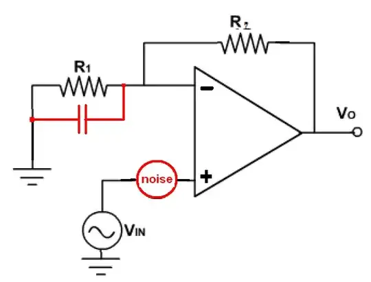

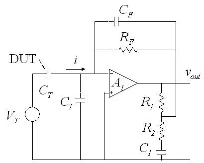

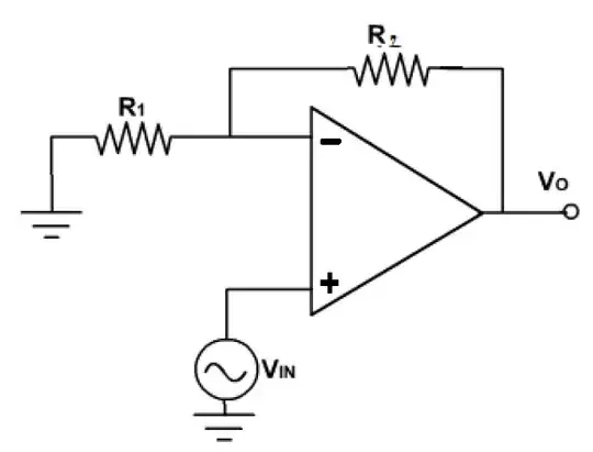

Noise gain is how the noise (internal to an op-amp's input) is amplified by the feedback resistors IN CONJUNCTION WITH (very importantly) the "invisible" capacitance from the inverting input to ground i.e. the inputs parasitic capacitance. Consider the standard non-inverting amplifer: -
We normally assume that the output voltage equals \$V_{IN}\times 1 + \dfrac{R2}{R1}\$ until the frequency reaches the limit where the falling open loop gain causes the closed loop gain to fall accordingly. I'm going to add two things to the above circuit that make things more relevant in terms of how noise gain is analysed: -
The two components added are the leakage capacitance of the inverting input and the internal noise source inside every op-amp input.
From the perspective of noise (and signal), the gain is increased by the added capacitor across R1. R1 is shunted (at high frequencies) by the reactance of the capacitor. This means that both signal gain and (shall we say) noise amplification is increased.
So, the final part of this story is a bode plot: -
From DC upwards, amplification is determined by the conventional gain i.e. 1 + R2/R1 then, at some point, C1 starts to progressively shunt R1 and gain rises with frequency. This rising gain contines until it meets the open-loop response then, naturally falls as the open loop gain falls.
This is what noise gain is all about when applied to a non-inverting op-amp circuit.

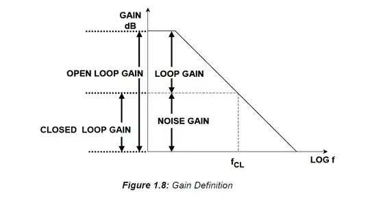

The noise gain of an op-amp is always given by \$G_N\$ = \$ 1\ +\ \frac {R_F} {R_{IN}}\$ assuming that the open loop gain \$AV_{OL}\$ is >> \$A_{CL}\$ (the closed loop gain) where for your circuit, \$R_{IN}\$ is given by (as you note) \$R_G\$ || \$R_N\$. This is the non-inverting gain of the amplifier and is true for both inverting and non-inverting configurations.
The noise gain is used for stability criteria, not the signal gain.
Here is a handy little graphic:
Gain definitions
If the amplifier has very high open loop gain, then the closed loop gain is the noise gain.
Signal gain and noise gain for various topologies
Your circuit above is the same as circuit C.
As you have found, by varying \$R_{IN}\$, you can change the stability margin at the expense of more noise and offset.

  • This is interesting- For an ideal op-amp your Rn does nothing and noise gain is the same as signal gain, right? (zero volts between + and - inputs.) For a real op-amp there will be some effect due to adding a resistor between the + and - terminals, granted, but it doesn't intuitively seem like it could change the gain from the non-inverting terminal by an order of magnitude. How did you get the cyan trace showing the noise gain = 100? – John D Aug 13 '16 at 05:21
  • It is interesting, isn't it? It kept me puzzling all weekend :) I don't think it has to do with real vs. ideal. It *does* seem to have to do with AC analysis vs. DC analysis though. If you do AC analysis of the feedback fraction (short independent V source V_sig), then it produces exactly the right result, with is 90k/.909k = 100 (40dB). – scanny Aug 13 '16 at 05:25
Regarding the inverting configuration, it´s said: "Rf and Rin appear in both the β and Ti block expressions. This reflects the interdependence between the feedback network and the input attenuation network. Changing one of the impedances therefore changes both the signal and the noise gain. So it's not possible to modify them separately by changing values of the existing feedback network components"
But I think is posible:
Inverter with Rn compensation
Inverter block diagram
The close loop gain is
The input is attenuated by The input is attenuated by
β is: β is:
The gain is the same that without compensation
Noise gain now is:
Noise gain now is:
Instead of:
Instead of:
Conclusion: We modified the noise gain without affecting the signal gain in the inverting configuration.
