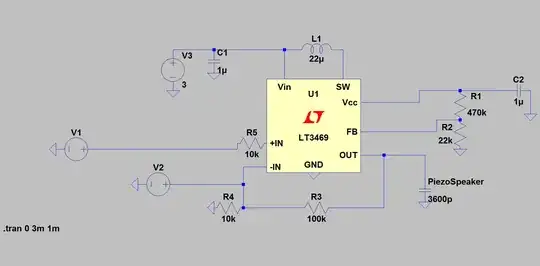

enter image description hereI have a square wave the oscilates at 25khz from 0 to 30v. I would like it to oscillate from -15v to +15v. Is there a SUPER DUPER SIMPLE circuit to do this? Keep in mind it's going up and down at 25khz.
Here's the circuit. The square wave I want to shift is going into the PiezoSpeaker at the lower right of the circuit.

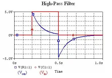

How do you shift a square wave down?
Just an RC will do it: -

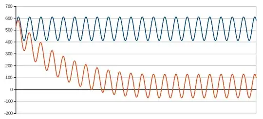

If fed with a sine wave (for the convenience of the attached picture), it will reproduce the sine wave at the output but with the DC level removed thus maintaining the correct peak-to-peak amplitude. Here is what happens in the first few cycles as the DC level is removed: -
It will work in the same way as a square wave (DC or average value = 15 V will be removed) but, please ensure that 2\$\pi\$RC << than 40 us to ensure the following doesn't happen: -
If C = 10 uF and R = 1 kohm, the cut-off frequency will be 15.9 hertz and miles away from causing the droop problem seen above.
However, if you in fact have a non 50:50 duty cycle square wave you may need a more complex circuit because the DC level won't be at the midpoint of the waveform.

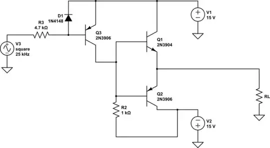

A simple circuit using a few jellybean BJTs:
It won't get quite to the rails, maybe +/-14V with 15V rails, depending on the load.
No fuss, no startup transients, can't go beyond the rails, it will just work.
