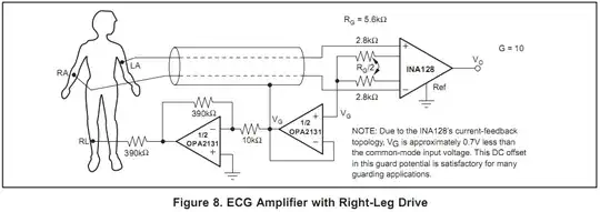

1. Use an Instrumentation Amplifier as the pre-amplifier (with right-leg drive)
An instrumentation amplifier, among other things, has a very high input impedance. This is ideal for measuring small currents. See the datasheet for the INA128. Page 11 has a reference schematic (attached below) which is similar to what you are looking for.
Reference schematic from INA128 datasheet page 11.

  • I'm looking at this in detail now, and that's actually not a great driven right leg circuit. The idea of a driven leg circuit is to decrease the effective impedance of the right leg (ground) electrode, and the 390k resistor just blows that away. http://www.heartrhythmuk.org.uk/files/image/Case%20Reports/image%20wilsons%20fig%203.jpg shows a better arrangement, with that resistor (which is for patient protection if the amp is saturated) being inside the feedback of Rf. That said, the circuit you use pops up all over the place, and I suspect they all come from the same (wrong) source. – Scott Seidman Mar 19 '14 at 16:52
    @ScottSeidman If the purpose is to decrease the impedance of the person relative to ground, to swamp out the Cbody capacitance, why not just ground the patient? Also, the common-mode voltages could be 100 VAC, no? How does an op-amp that can only drive ±15 V cancel it out? – endolith Mar 04 '15 at 21:53
    @endolith - common mode voltage we're talking about is well within rails. The amp inputs are usually diode clamped to the rails, and common mode input ranges for the In-Amps are relatively small. Larger transients are dealt with by spark-gaps (ever wonder how an ECG can survive defibrillators?). The purpose isn't to lower impedance wrt ground, its to lower the effective impedance of all electrode-skin interfaces, and thus make them closer in value (it's the electrode contact mismatch that's the issue). See http://www.elastyc.unimore.it/fonda/ELBIOM/Driven-Right-Leg%20Circuit%20Design.pdf – Scott Seidman Mar 05 '15 at 13:33
