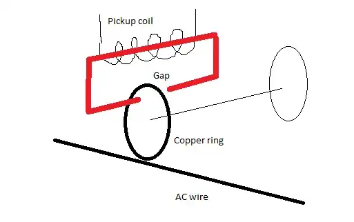

Rotating transformer
The 4 tires is the parts closest to the road surface. The pickup zone of transfer can be near 100% efficient if the space inside the tires can be involved.
Embed 2 long wires in direction of road. They should match width of vehicles. Embed single turn shorted coil into each tire. Mount pickup coils anywhere around tire on the vehicle keeping the axes in parallel to wheels axes. The magnetic cores for pickup will be C-shaped "biting" into the wheel's "shorted coil".
The scheme is similar to rotating transformer. It was used in video tape recorders. Red is core. Black is copper. There can be more to it. Like C-shaped magnetic inlay around copper ring. Even embedded schematics into wheel, instead of single ring, etc. Red is core material. Black is copper. Note that there are NO electrical contacts, only gaps everywhere.
    In the rotary heads of a VCR or DAT recorder the two coils are at a couple tenths of a mm apart. In your idea the coupling coefficients \$k\$ are low, especially the one between the wheels and the cable in the road. I can't give estimates for their values, though. In any case for a car the shorted wire in the wheels exists: it's the tire's steel cord reinforcement. – stevenvh Jun 02 '12 at 15:40
  • The gap in video transformers is between halfs of core, not between coils. Coils can be anywhere as they encircle the dissection of magnetic path. For 2 wires far apart and twisted every hundred feet, loaded with capacitor bank down the road say at 60 Hz there is no field related losses. At resonant currents of several Ampere nothing prohibits the same order of currents to exist in the ring. The only rule is that gap between ring and wires should be much less than distance between the wheels. With distance of single inches and in milliTesla range it is feasible way to deliver with low losses. –  Jun 02 '12 at 17:03
  • Does this mean that you require the same width for all vehicles? – clabacchio Jun 04 '12 at 15:09
  • Yes. But same width is already sort of established since the time of carets with 2 horses in a row. –  Jun 04 '12 at 23:00
