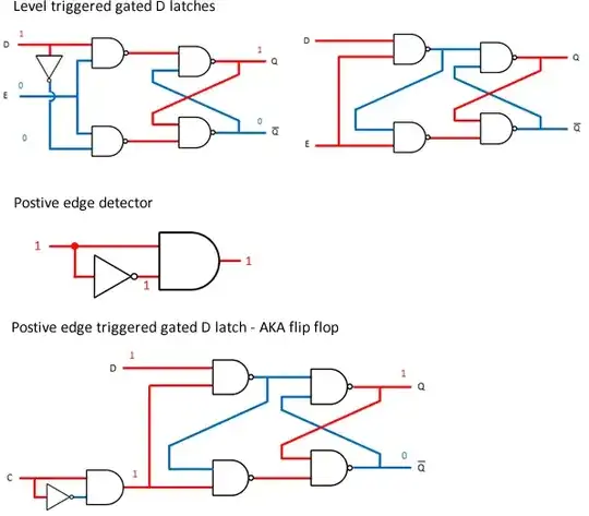

My current understanding, which I want to check, is in the diagrams below…
Side by side are what I understand are two implementations of a level triggered gated D latch.
Below these is a positive edge detector, at that brief moment when the NOT gate has not yet responded to the change input from low to high, namely the rising edge (red is 1 blue is 0).
In the last diagram, the edge detector has been fitted to a dated D latch and this is what makes it a flip-flop.
Is the last diagram really a flip flop, or is it still just a latch?
And why do we need the master slave version given, that this device is so much simpler?

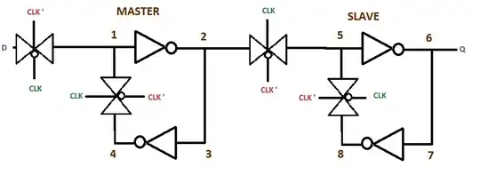

A flip flop is most typically characterized by a master-slave topology. This is two coupled (there can be logic between), opposite phase latches back to back (sometimes in industry called L1/L2).
This means a flip flop inherently consists of two memory elements: one to hold during the low cycle and one to hold during the high cycle.
A latch is just a single memory element (SR latch, D latch, JK latch). Just because you introduce a clock to gate flow of data into the memory element does not make it a flip flop, in my opinion (although it can make it act like one: i.e. more rising edge triggered). It just makes it transparent for a specific amount of time.

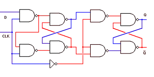

Shown below is a true flip flop create from two SR latches (notice opposite phase clocks).
true d ff
And another true flip-flop (this is the most common style in VLSI) from two D-latches (transmission gate style). Again notice the opposite phase clocks:
true flip flop tg style

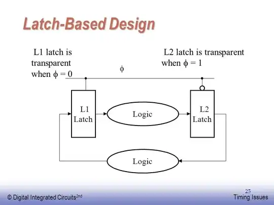

EDIT For some clarity I included a graphic of latch based design. There is a L1 latch and L2 latch with logic in between. This is a technique which can reduce delays, since a latch has lesser delay than a flip flop. The flip flop is "spread apart" and logic put in the middle. Now, you save a couple gate delays (compared to a flip flop on either end)!
latch based design
