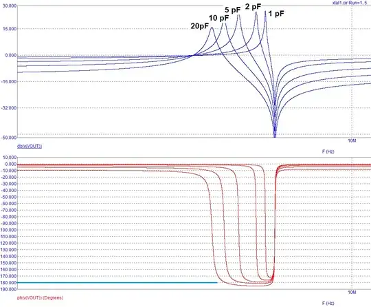

Look at this response - it mimics a crystal and one capacitor but it doesn't quite reach 180 degrees: -
V1 is the driving voltage source and R2 (100 ohms) represents the output impedance of the gate involved in the oscillator. Look carefully, the phase angle doesn't quite reach 180 degrees and this will mean NO OSCILLATION.
The extra few degrees of phase shift come from the output capacitor on the invertor - the 100 ohms (or whatever the output impedance of the inverter has) AND this extra capacitance push the phase shift past 180 degrees and the oscillator will then oscillate.
Here's a picture showing the effect of increasing input and output capacitance from 1 pF up to 20 pF: -
The X axis is at 9.9 MHz FYI. As you can possibly see, only when capacitance is 10 pF or 20 pF does the circuit produce 180 degrees of phase shift. This means the oscillator will oscillate at the left hand point on each phase curve that the response crosses 180 degrees (parallel resonant point tuned by the external capacitance).
So, you need capacitors to make this type of oscillator work and the manufacturer tells you what to use but, in my humble opinion, there are a lot of subtleties around that some manufacturers maybe either don't fully know or won't tell you. I'll also add that there appear to be very few web articles about what really is going on and the true importance of each capacitor.
