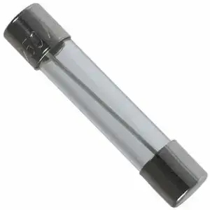

  • Other than "Fuji5A" it has some sort of a symbol with a "T" inside of it, but I'm not sure if this is just a logo or something similar, or part of the labeling: https://lh5.googleusercontent.com/-FZpwEjf3oX0/TxEWa51gEMI/AAAAAAAAAEY/ENx2NGGrTzs/w703-h527-k/100_3245.JPG – Sean Jan 14 '12 at 05:46

Typical slow blow fuse. Here the coiled structure is clear. Sometimes it is visually less apparent.
I've seen it suggested by some sites only that slow blow use lower melting temperature materials - but this is not a certainty.
