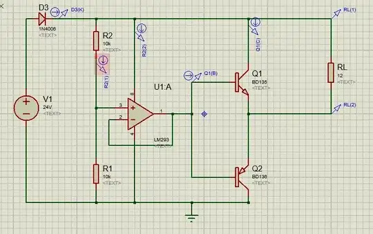

I have a 24V battery and I'm trying to obtain a virtual ground from it. 90% of the circuits I found limit themselves to an opamp, which has very low current sinking. I'm trying to add a pair of transistors in push pull configuration, but my simulations are failing and I have no idea why. I would appreciate very much if someone could help me with this.
So far, so good. I'm simulating the scenario in which I have nothing connected between -V to 0, and a high load connected from 0 to V+. I'm having 10.8V on RL and that's great. But, when I try the scenario in which I have nothing connected from 0 to V+, and my load is between V- and 0, I get 0V on my load resistance.
I thought that, in this second case, the opamp would provide a small base current for the Q1 transistor, which then would drive a higher current from the V+ line and feed the load resistor. It doesn't seem to work this way, however. Please, could anybody enlighten me or give me a few tips?

The problem is that your feedback signal is taken from the wrong place.

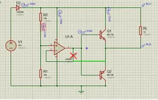

Figure 1. Corrected feedback loop. (Red = remove, green = add.)
In your original layout the feedback signal is monitoring the output of the opamp but has no idea what's happening at the load which is where it matters. If the circuit is working the voltage at RL2 would be the same as that on pin 3. I think that if you measure it you will find that it is out by 0.7, the emitter-base voltage drop of Q2.
Instead, take the feedback from the junction of Q1 and Q2's emitters. The opamp will now correct until that point is at the same potential as pin 3.

It is failing in simulation because you're using a comparator rather than an op-amp.
The comparator is not unity-gain stable and it has an open-collector output, meaning it can't source current and if it could, it would oscillate.
Use a op-amp such as an LM358 and it will work, but it would be better to feed back from the output (transistor emitters) rather than the op-amp output. There is little danger of instability unless you have a very large load capacitance, because the transistors have no voltage gain.

A glaring problem in your example is that you hadn't provided any biasing for your BJTs. They each need a \$V_{be}\$ to operate in their active region and tying the bases together means that isn't going to happen. Their emitters are then just mostly "floating." So you need to start out by providing reasonable biasing.
A very cheap way to do this is to jack the bases apart by using two diodes which themselves are forward biased and operating. (You 'hope,' for now, that the two diodes provide enough of a difference to provide that biasing.) A resistor can provide those diodes with some current. But you'll need two in this case, to put the diodes roughly at the midpoint and also so that both bases aren't tied to their collectors. Those two resistors, in my first example these are \$R_3\$ and \$R_4\$, should be of the same value to do that.

You write you're satisfied with 10.8V when you draw current from the positive rail. You shouldn't. You expect 12V, as the virtual ground is right in the middle. The difference comes from the base-emitter voltage of Q1. This can be compensated for by deriving the feedback from a different point, as Transistor has pointed out. With his modification, you'd get 12V over the load.
But this does not solve the question your asking: Why doesn't it work at all when drawing current from the negative rail. The answer is it does not work because you have not used an operational amplifier. The LM293 is a comparator with open-drain output. It sinks current, but does not source it. Replace it with a real operational amplifier, like the TL081 that was mentioned in another answer, and your problems are gone.
