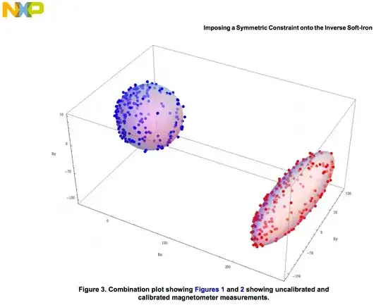

The discussion in this answer to Magnetometer ∞ shaped calibration as well as the 3D plots of data give an excellent overview of what is happening mathematically. Roughly speaking, six parameters - a gain and an offset for each of the three axes - are fit to a dataset collected over a cloud of data points that at cover at least a chunk of that sphere.

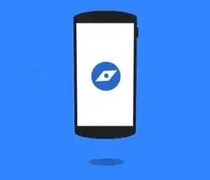

above: After paying a zillion dollars for a very nice phone, I feel like an idiot doing this (from support.google.com/maps) while balancing on a bicycle on a busy street corner, or enjoying some beautiful view on a hike. My iPhone makes me go through a much longer, silly video-game-like task before it will even begin to tell me anything useful. I cary a normal compass sometimes because it just simply works.
above: Screen shot from this nice discussion of the principles and mathematics behind magnetometer based compass calibrations. Here is another.
