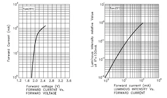

Using the datasheet I linked we can see that the luminous intensity of the red LED is typically 4.2cd, if we want to match this to a green LED with a luminous intensity of 2.8cd we need to look in the datasheet of the red LED and find two graphs. Forward Current vs Forward Voltage and Luminous Intensity vs Forward Current.
Using our example value of green being 2.8cd, our 4.2cd red LEDs luminous intensity needs to be at 66% of its current value (2.8 is 66% of 4.2). In the graphs from the datasheet, we can now calculate the forward current required to have the red LEDs luminous intensity at 2.8cd and also the forward voltage.
Now that we know what the forward voltage of the LED required for 2.8cd we can adjust our first schematic accordingly
