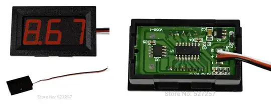

A cheap (compared to other costs) and almost parallel input brain-processing system is to use a per cell voltage monitor with display. Analog and digital both have their place in such systems, but a low cost self powered system is possible using off the shelf self powered digital voltage meters avaiable from various Asian sources.
You can buy 2 wire self powered meters operating from eg 3V-30V for typically $US1.20 - $US1.50 each with 3 digit LED displaay and calibrate-it-yourself accuracy.
This is an example only with NO intention of recommendation. Note they say 3V minimum in the heading and 2.5V minimum in the text. YMMV :-).
Image from above site:

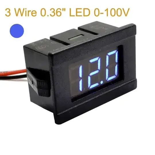

You can also get 3 wire input versions with 0- 99.9V (3 digit) V measurement and eg 3-28V power supply inputs. These are provided with Vin, V+_supply, common connections and if Vsupply_min is below the voltage to be measured Vsupply can be obtained from 1 battery further up the string. This is less convenient, gives slightly more chance of fiery or silent or magic smoke meter catastrophe when you get it wrong but allows true 0-xx volt input range.
Ali Express 3 wire meter - AGAIN example only.
Both arrangements imposes a small current load on the cells being measured, but this will be far lower than the currents in question and liable to be neglibgle or able to be allowed for. As the meters will draw power whenever connected the best arrangement is probably a multi cell plug connected into the BMS - either BMS turns off power or meter plug is pulled.
