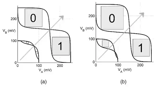

In fact, there is even a paper "Power-Up SRAM State as an Identifying Fingerprint and Source of True Random Numbers"
One very helpful plot contained in the paper is below. The dotted line represents the supply voltage ramping up:
metastability at powerup
  • On the left-side, everything is equal. In this case, random variation due to temperature or another number of factors bumps the bitnode into one state or the other.
  • On the right side, there is a bitnode which is skewed (purposefully or otherwise) to be much more likely to initialize in a particular state.
Depending on how each bitnode in the SRAM you are using currently was fabricated, you end up with more or less of one of the two situations above. In both cases, unless you intentionally skewed the SRAM, the initial outputs would look more or less random. In the left-hand situation, each subsequent powerup would generate more random patterns. In the right-hand situation, the initial startup would be seemingly random. But further powerups would cause the SRAM to tend to further certain states.
