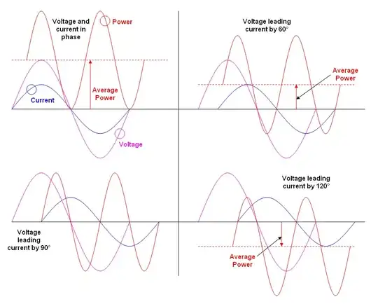

A few examples of V x I and the power waveforms they produce: -
Average power x time (i.e. watt seconds or kWh) is what you are billed on.
You could call real power average power if you want or you could use it to refer to the waveshape of v*i.
