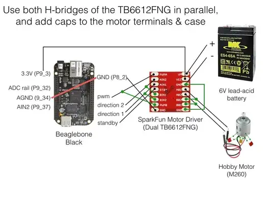

I'm working on a regenerative-braking project with a DC motor. My Beaglebone Black drives a small DC Motor using a TB6612FNG motor driver from Sparkfun (datasheet):
BBB motor driver schematic

The program hangs regardless of whether I connect analog ground (AGND) to the Beaglebone's system ground (GND) (the pink line in the picture). When they are disconnected, my DMM's "max" function measures a 70mV spike between them when the motor changes direction.
As the picture shows, the battery's negative terminal is connected to "GND" on the right side of the motor driver. The program hangs in this configuration. Additionally, the program also hangs if I connect the right-hand side motor driver "GND" to its left-hand "GND". My sense is that these should remain disconnected because of the large currents through the battery.
There is a 0.1 uF capacitor across the motor terminals. My crappy LCR meter says the motor's inductance is 1 mH. I have not placed any other capacitors in the circuit.

I'm happy to report that we "fixed" the problem yesterday by putting two 1uF caps between the motor terminals and the motor case:
The yellow "104" cap (0.1uF) was already there; the motor shipped with it pre-soldered to the motor terminals.
Here's what it actually looks like:
Another trick we used -- although it didn't fix the problem -- was to run the two H-bridges on the TB6612FNG in parallel, like this:
This way, the bridges share the current, so it should've helped if we had been over-currenting the driver.
This technique was recommended by this application note:
http://www.nxp.com/files/analog/doc/app_note/AN4833.pdf
and this example, which uses the L298 motor driver:
http://www.st.com/resource/en/datasheet/l298.pdf
