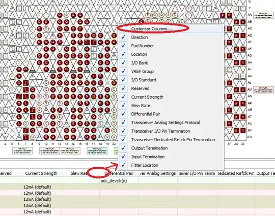

In the pin planner window, in the All pins view at the bottom, right click on any column header, and select "Customise Columns":
Customise Columns
In the window that opens, scroll down in the left hand side and find "Weak Pull-up Resistor" (it's third one up from the bottom on mine). Click on that, then click the right arrow button to add it to the visible columns. Then click OK.
Show Weak Pull-Up

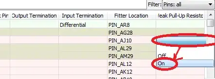

Now back in the Pin Planner window, you should see a new column called Weak Pull-Up Resistor. For each pin you wish to enable it on, simply click in the box for that column and select "On" (you can also type On into the box). By default it is turned "Off" - so if the column is blank, it means the same as if it says off.
Enable Pull-Up
